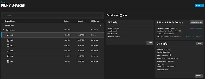

As long as you do not reboot the problem drive will keep its letter. Write down its serial number for when you will remove it.

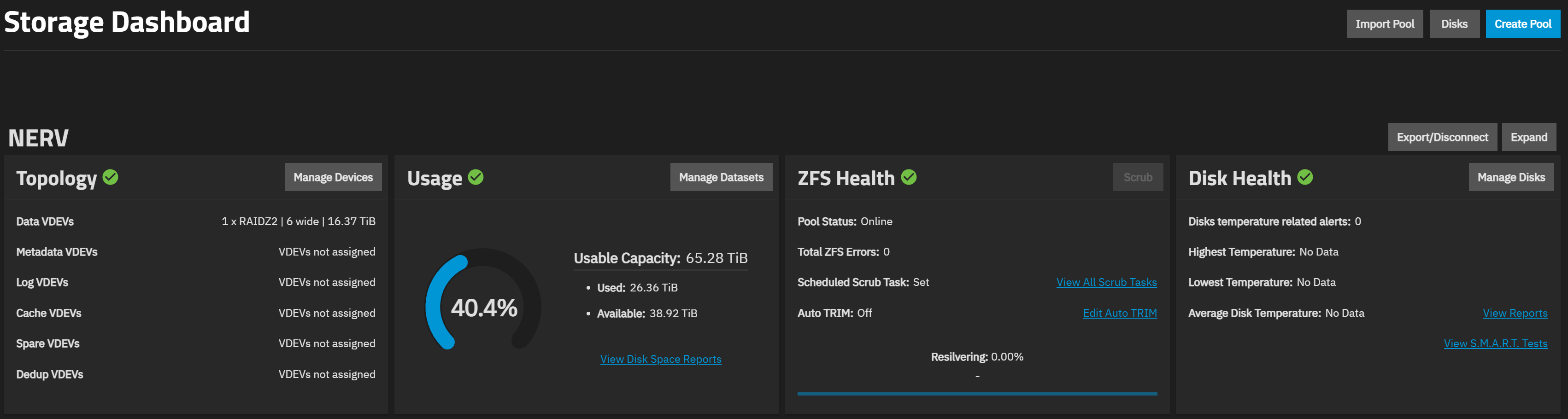

Keep the iffy one in there, as you have enough slots, and click on the “Replace” button that is clearly visible in the bottom right corner of your screenshot.
You can do that already, or wait for the long SMART tests to complete first.
I’m afraid you’ll have to: Checksum errors could be the cable, the controller, or a flaky PSU (but the last two would probably show up on multiple drives), but read errors are most likely from the drive. We can help you decyphering the SMART report when the long test has finished to confirm.

I have a wide variety of files from video to text. Scrub takes about 24hrs.
  • Data Topology: 2 x MIRROR | 2 wide | 12.73 TiB
  • Usable Capacity: 25.32 TiB

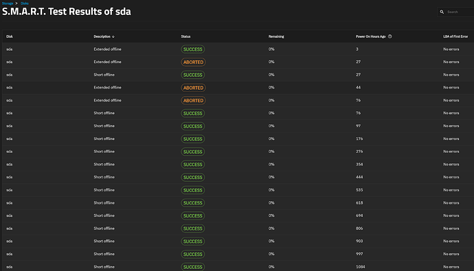

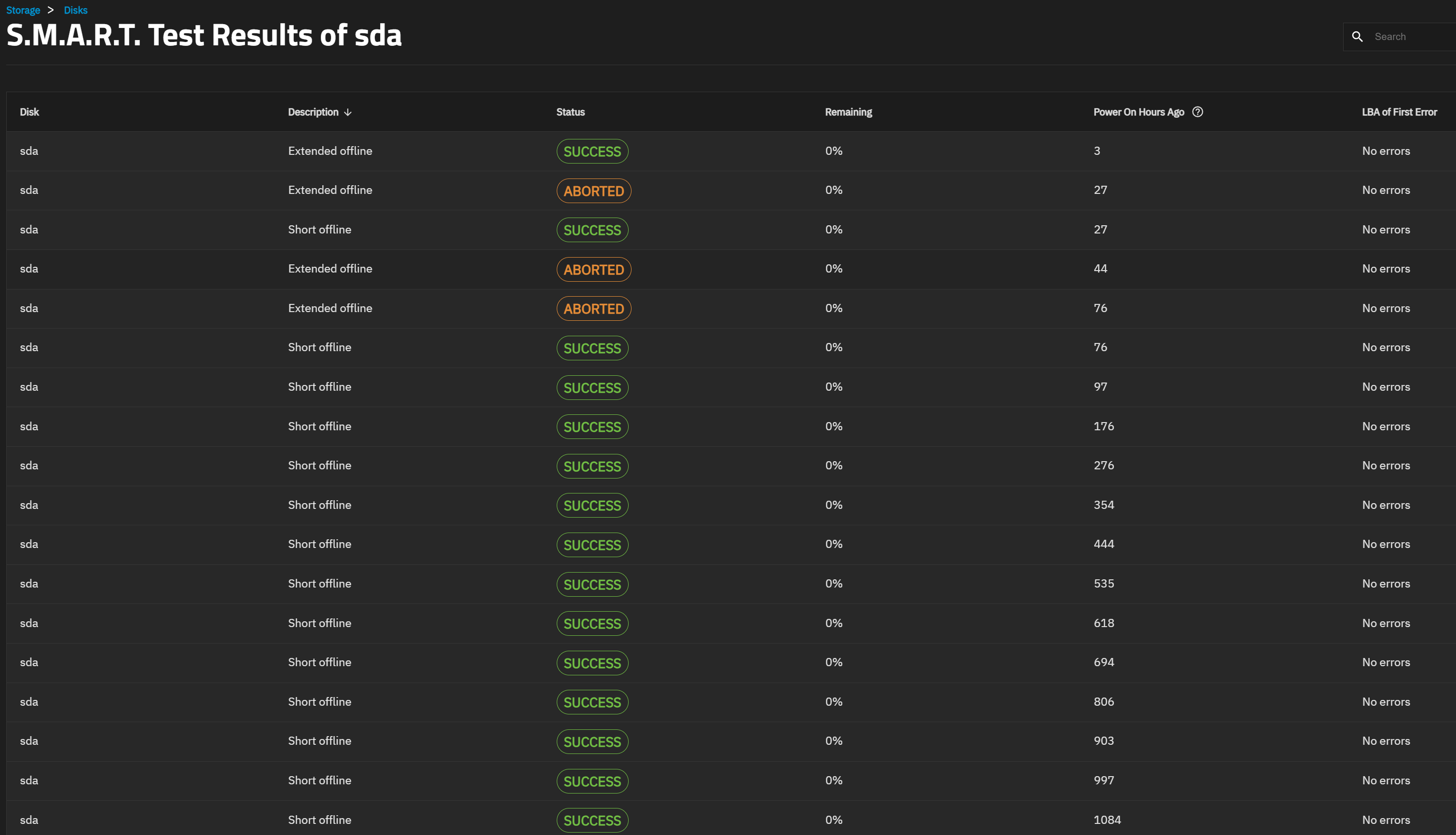

SMART tests on all drives have finished wis I believe no errors:
Still have this though:
So I am wondering if I still replace it, or clear and see if it comes back?
In your screenshot I only see 4 extended tests and 3 of them aborted before they managed to complete.
A short test is effectively useless at catching all but the most obvious and total fault.
What you do in terms of replacing the failing drive is up to you. If you changed nothing in terms of how you connect it, I imagine it will fail again soon.
It’s your time and your data.

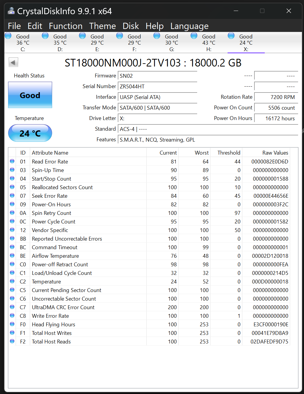

Yep, that’s my plan. About to plug the now pulled drive into the desktop and test it on there. Just need to pull the back off the case and run some cables. I remember when I installed these I ran a full surface test through hard disk sentinel. Should I do something like that again or just run tests through something like Seatools?
As it turns out, X870 ProArt only has 4 ports and all are in use, but as luck would have it, had one of those USB adapters laying around.

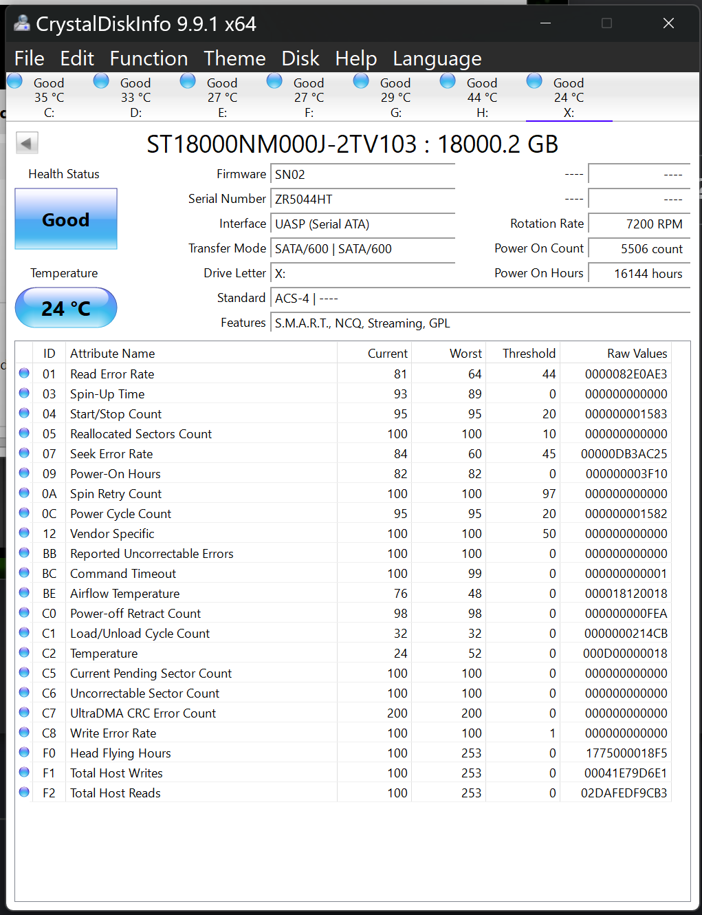

Current info but long test running in Seatools.
Well then, kinda light on details. Maybe it’s ok after all and just something weird happened in a file transfer? Thinking it might be ok to just keep this one one hand as a spare now?
Details would come from smartctl -x (or -a) on the command line, or at least some utility like the one you used to provide a screenshot in your previous post.
It’s plugged into the PC now and not in the NAS anymore.

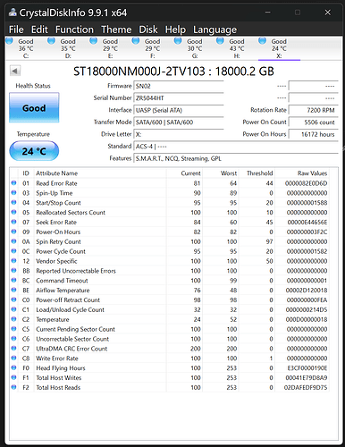

SMART info:
And the Seatools long test doesn’t give me any details other than it passed.
Your Seatools image looks to have a Results button at the bottom. Maybe that is how you view?
That screenshot I took is the results page, quality application.
In CrystalDiskInfo, go to Function, Advanced, Raw Values, 10 DEC for much more human readable information in the bottom half of the screen. (This is from memory so i may have missed one step in the menu, but you’ll find it.)
