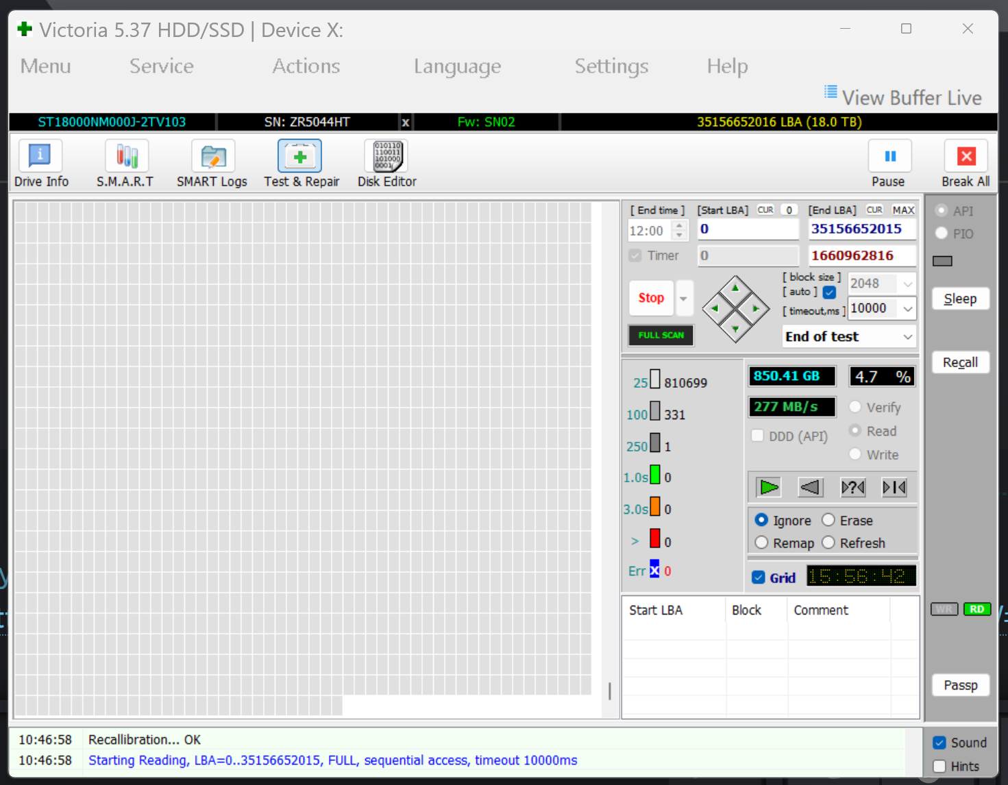

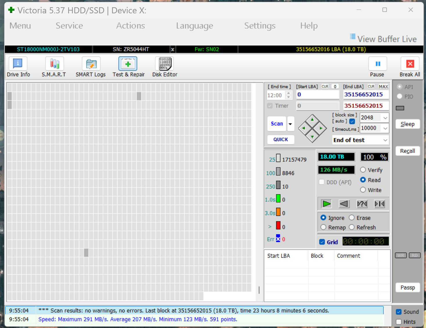

16 day scrub time?
Something like that?

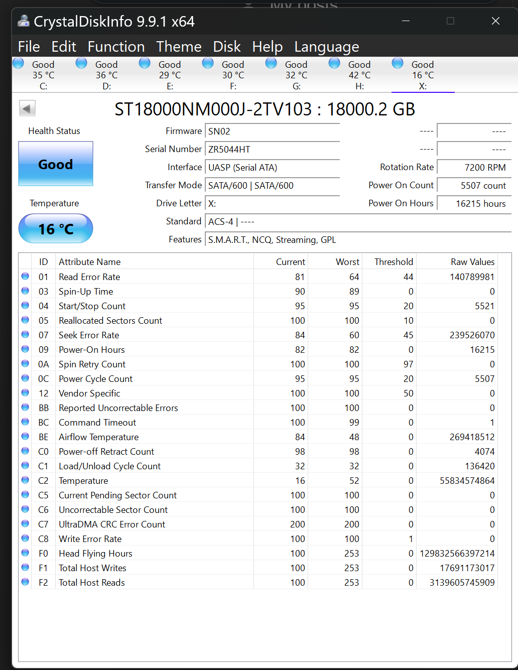

I certainly prefer it to hex.
Wouldn’t seagate still need additional something to translate the raw into something readable?
I only have the command saved somewhere for smartctl. Never tried it in a gui frankly
The most relevant values are directly readable. Hex or decimal, the temperature readings do not quite make sense but there’s nothing obviously suspicious. The long test has not halted on reading some sectors, as one could have feared.
Still I’d like to see the log of SMART errors from -x or any equivalent display in a GUI.
True, but was wondering about the Raw values for field 01/05, also wondering if field BC is why we had this one shitting the bed. Always a pain translating some of this stuff.

mind doing this: smartctl -a /dev/sdc -v 1,raw48:54 -v 7,raw48:54
It’s back on the PC right now running through this:
But when it’s done, I will swap it back over and check that.
And finished scan with no warnings. Will swap it back into the NAS tomorrow and run - smartctl -a /dev/sdc -v 1,raw48:54 -v 7,raw48:54
Note you did a scan. I was reccomending a complete low level format with multiple bit patterns. This will take something in the order of a week with the size of the disk you are talking about.
