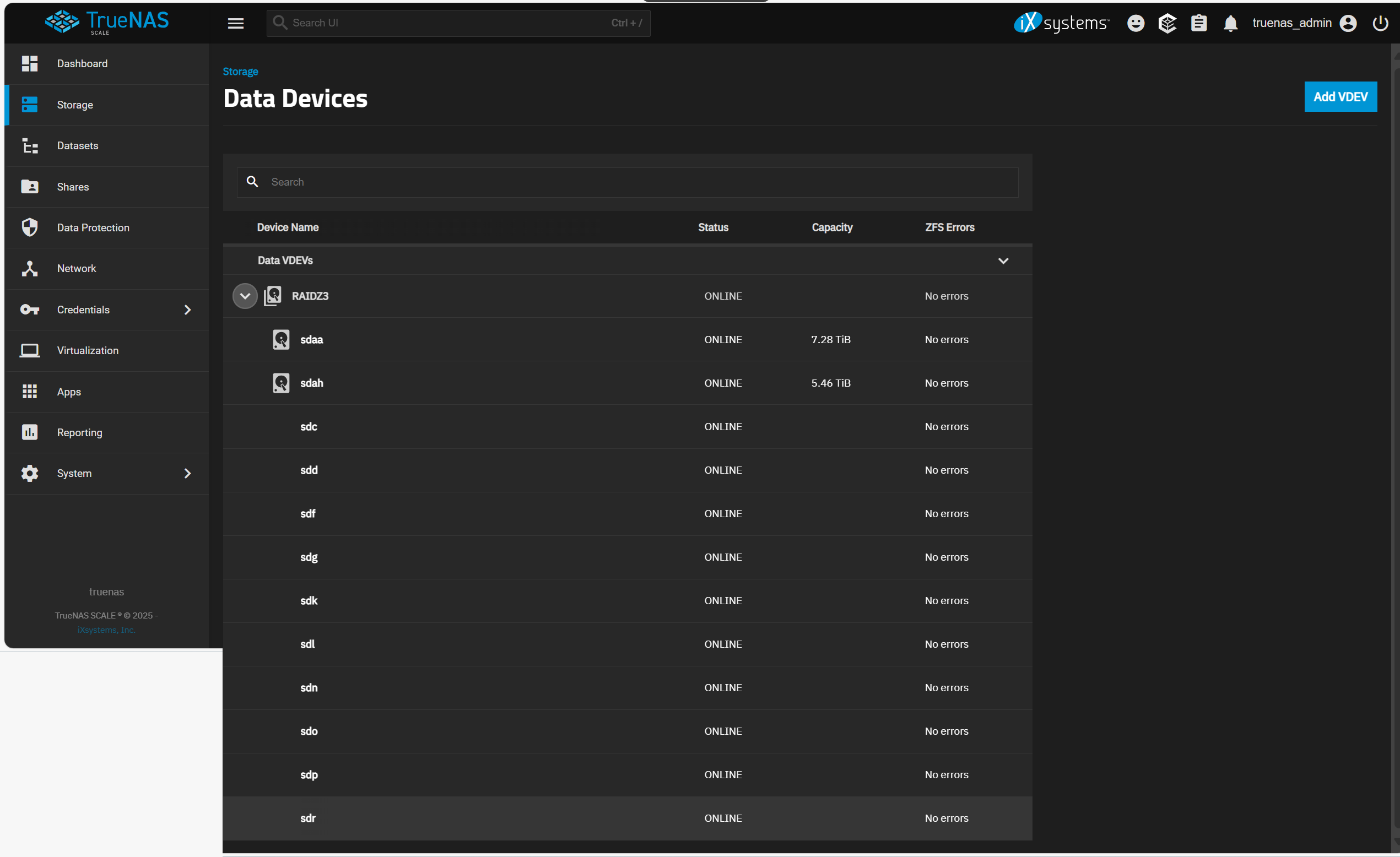

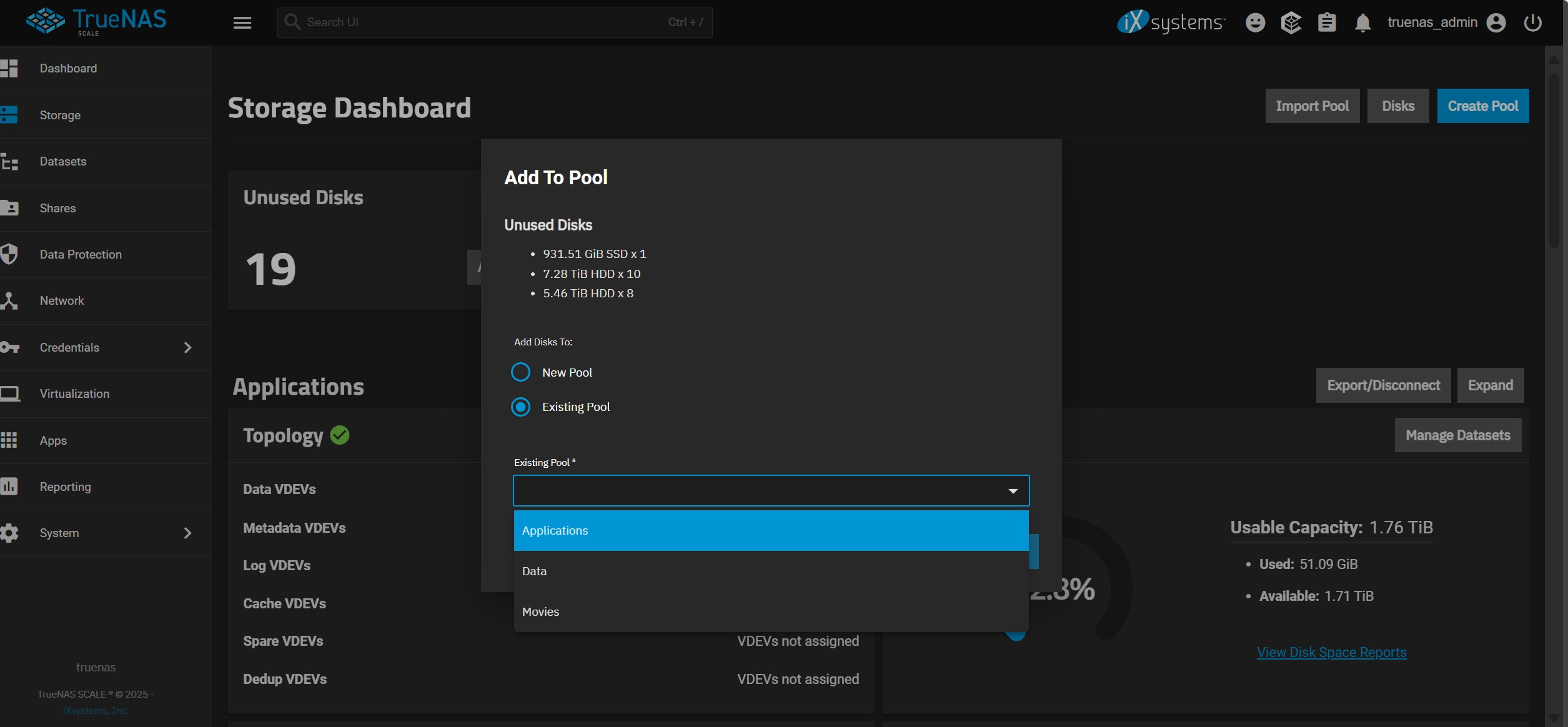

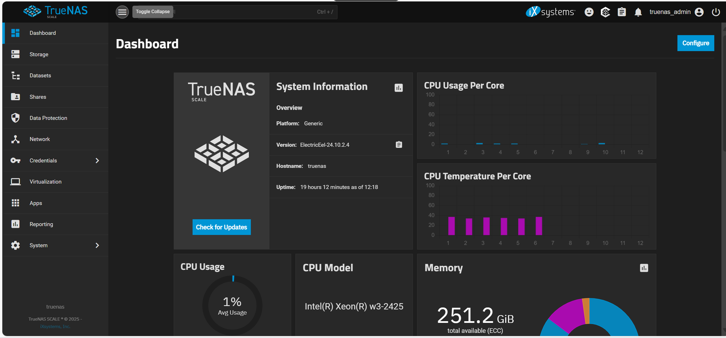

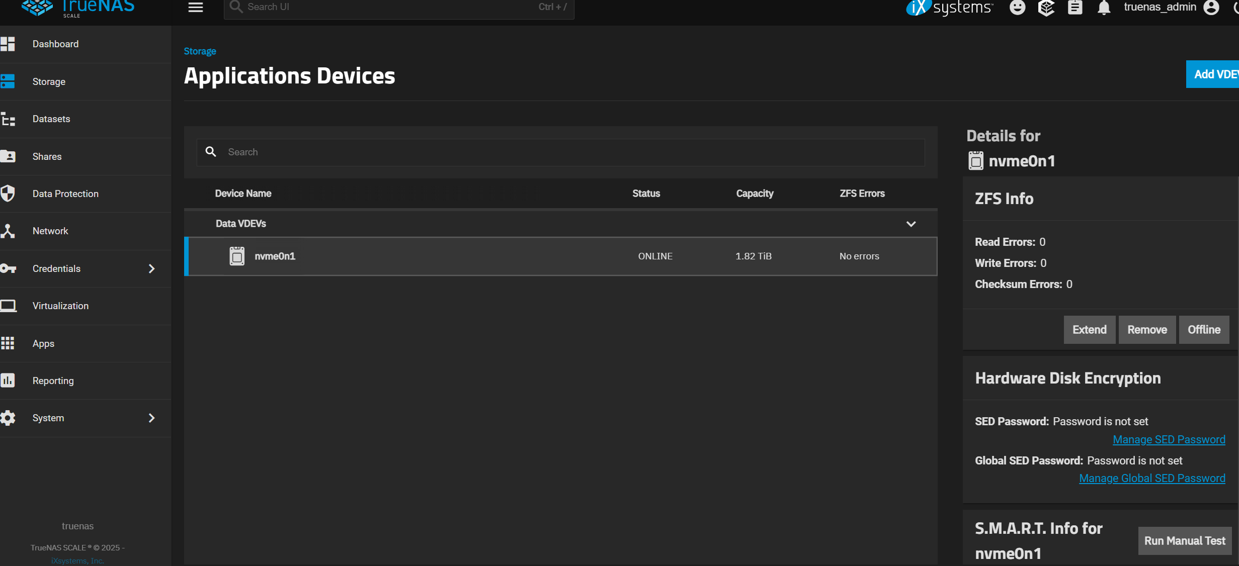

Hello, I am running TrueNas Scale ElectricEel-24.10.2.4 and recently transferred my pools to a new server. My Storage shows 19 unused disk and 28 total disks. I have an LSI_SAS_9300-16i_UG Raid Controller Card with a BPN-SAS3-846EL 1 backplane. Asus Pro WS W790E-SAGE SE w Xeon w3-2425 and 256 GiB ECC ram. I have 3 pools 2 RaidZ3 w 10 drives various sizes and 1 nvme with Applications on it. When I try to Add to Pool it will not let me separate
to each pool. Any ideas? Thank You, Mark
Your menus look funny. I can’t tell what menu option(s) you are on. Try rebooting or a previous boot environment, if you have one to see if it clears up.

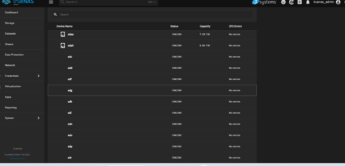

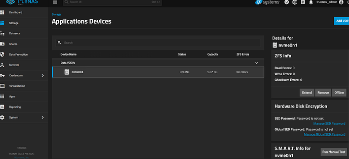

Post screenshots of your current pool set up, Applications, Data, Movies
