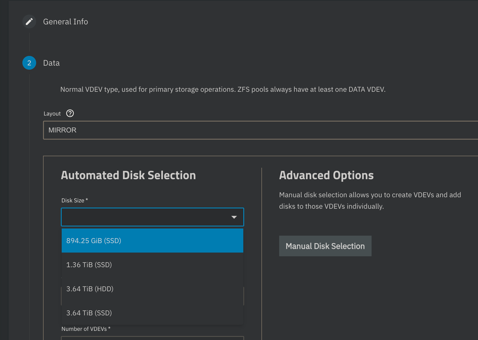

When i had a new mirror to a pool.
I select SSD…
but it add the identically sized HDDS instead
selecting the same size hdd also does the sam,e, as it should (i.e. its not that its swapped identification)

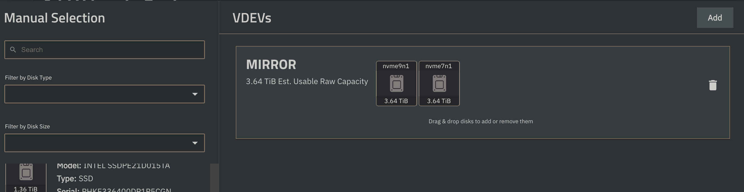

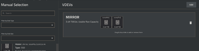

manually adding the disks like this works, funny bug! it really confused me when making my disks id script… couldn’t figure out why it insisted my nvme pool had hdd in it :slight_smile:

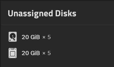

Super weird, I just reproduced this. Test pool used the HDDs instead of the selected SSDs. Will do some digging.

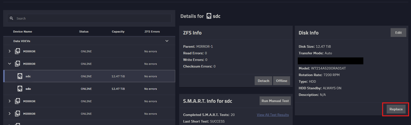

It is always possible to replace a drive, in any kind of vdev, so no-one would ever end up locked with an unwanted configuration.
to make sure i understand - so remove an HDD from the mirror and then add the SSD to the mirror? Will this redistribute data etc?
cool!
In the UI, you should just have the option to just click and replace:
So while it’s an annoying bug, it’s workable, and you only run into it if you have two disks (mixed types of SSD/HDD) of the same size.

“Replace” does not redistribute anything: Data is copied and then the drive is removed (or data is reconstructed from remaining drives in the vdev if you removed the drive first).
