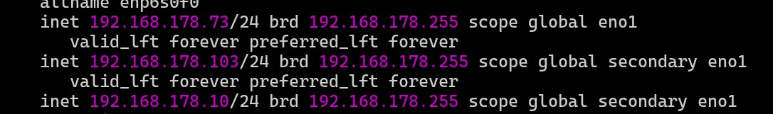

Digged a bit deeper, just to find out the order of IP addresses was mixed up. My main IP was on top in config screen, but IP addr showed it as secondary and a random other one as primary. Same for the state aliases view in console config. This leads to missing default gateway and the connection seems broken.

Ping to default gateway is only possible if -I with 192.168.178.10 is passed as parameters.
Looking at ip addr, the config seems mixed up.

Steps to reproduce took longer, as it was randomly working after the first second ip. But failed again after adding the third and reboot:
Fine after second ip and rebootScreenshot_20260411-172514
Messed up after adding the third and reboot
Judging from a short (non professional) research the order seems to be not correct to set the IPs, I don’t know why. My expectation would be, that the first IP in the list is set as first and main IP.
Removing the 103 and rebooting keeps the order…
Last time 10 and 103 mixed it up and 103 was before 10.

Edit: tested with 74 additionally and it works after reboot, 10 is still first.
Observation: the “first” IP in configuration is not regarded during boot.
Apparently it is some kind of sorting active, which might mess up the network configuration.
Suggestion: Activate IPs in the order of configuration, shown in the UI, thanks.
