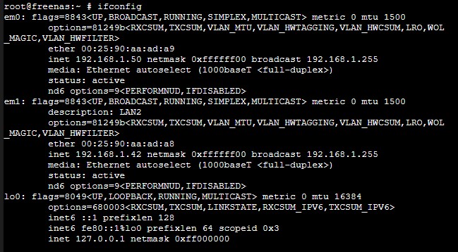

Also, can you please post the output of ifconfig?
It should show the current network config.

I see you have two NICs each with its own IP on the same network, that’s known to cause issues.
But I wonder if there something else going on as well.

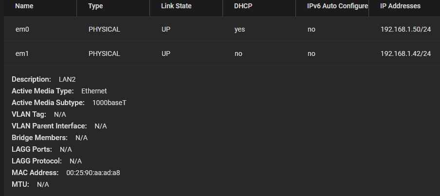

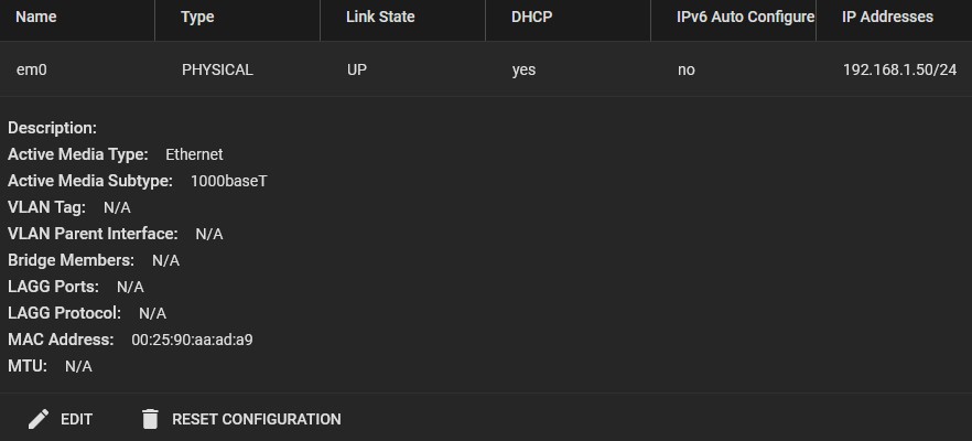

Can you please post the screenshots of how the “Interface settings” for both em0 and em1?
Also, have you set up any static routes? (if yes, why?)
There is one entry under static routes. Destination and gateway are both 192.168.1.1. I don’t know why it’s there or whether it should be. Are these the screenshots you wanted to see? I don’t know why I have two NICs connected. I don’t know enough to have set them up for a particular reason. I don’t think I need any interface binding with my current setup.
Interesting. I tried unplugging one NIC and then the other. With em0 down, I still had my NAS accessible from other hosts on the LAN, and I still had my web admin page accessible. With em0 up and em1 down, the NAS was inaccessible, and no web page, even if I pointed browser to the em0 IP address. Either way, no pinging from shell, but with one of those, I think the ping returned something like “no network”. But now, with both NICS plugged back in, for the first time, I’m able to ping the nameserver, gateway, google.com, and the update-master URL at ixsystems. Now, when I check for updates it populates with base-os, freebsd, and freenas updates. I can go ahead and update, but probably still need to fix my configuration.
OK, I deleted the configuration for the second NIC, unplugged, and rebooted. When it came back up I was back to no pinging, no updates. I deleted the static route and that fixed it. I don’t know why that was there. I think I can go ahead and update now. Thanks for all your help.
