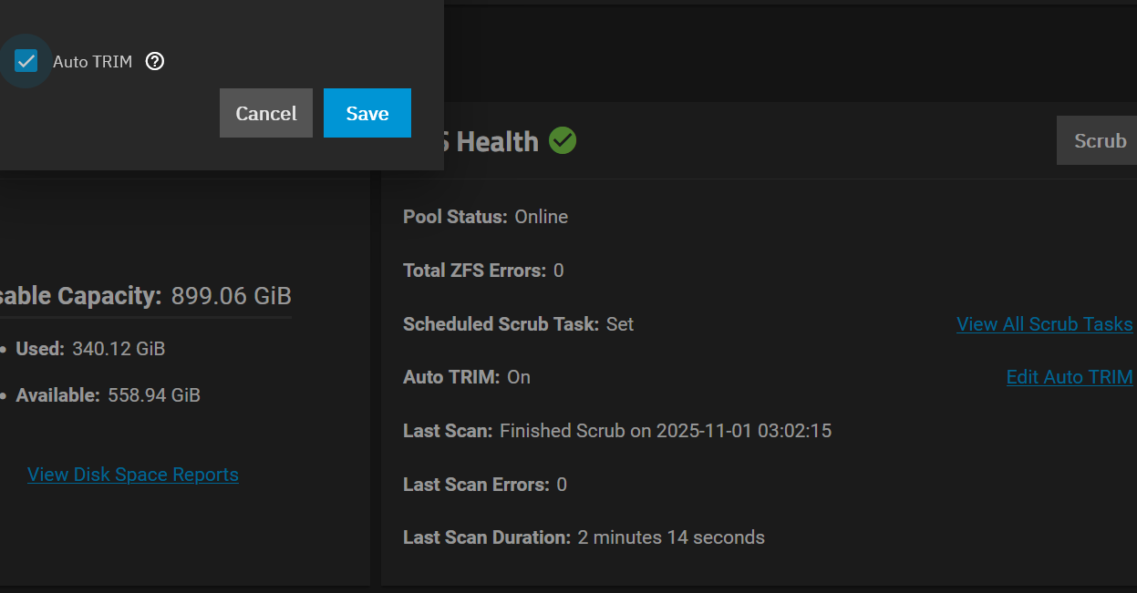

It could be a TRIM - that wouldn’t show up in disk activity as the OS isn’t interacting with the drive(s)

In the storage dashboard you can enable/disable auto trim for a pool… but this is a boot pool & I’m 99% certain that you can’t enable auto trim for boot pools, so I think that is out of the window too.

Also I noticed you’re on Core - some of my steps are for Scale… Sorry if screenshots don’t match Core UI, I’m still half sure that these are reasonably similar to what they used to be on Core.

The screenshots for Scale are similar with Core. Thanks for taking the time capturing and posting here!
