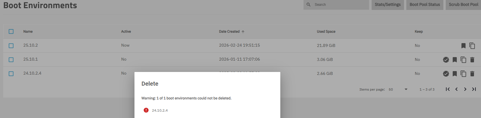

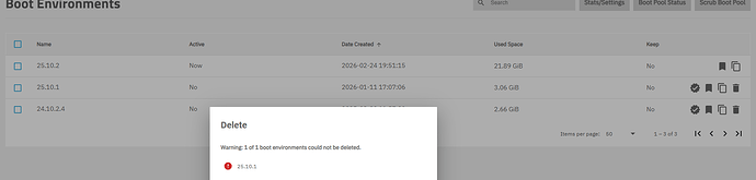

Boot environments could not be deleted
old boot can’t delete
I think you have the KEEP flag set for those. Look over the items on the right and unset the KEEP flag and try again.
keep flag is No
Time to download a System Configuration, do a fresh new install and upload your System configuration?

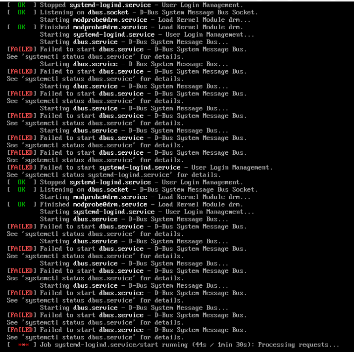

On boot menu ,I select 24.10.2.4
This error is displayed repeatedly.
You were supposed to run zfs get all boot-pool/24.10.2.4 when you were booted into 25.10.2
