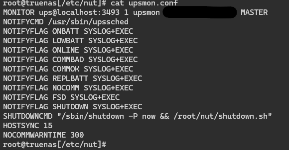

i’m an idiot, flip it, I was just reading UPS Shutdown Scripts.md · GitHub and they modify upsmon.conf to run SHUTDOWNCMD “/bin/bash /etc/nut/shutdown.sh >> /var/log/ups/ups.log” so if I just change the upsmon.conf to run the script at shutdown then that should be it
this should in theory work

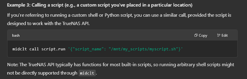

Chatgpt shows
so would something like
midclt call ups.upssched_event ${1} script.run ‘{“script_name”: “/root/nut/shutdown.sh”}’
be it?
Solution.
