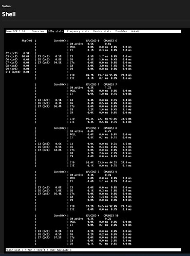

Powertop of the system with HBA and no GPU:

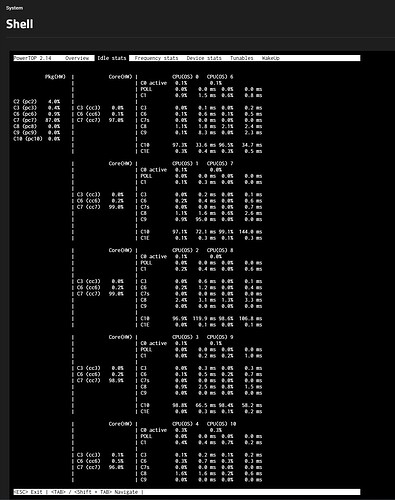

Powertop of the system with HBA and GPU:
