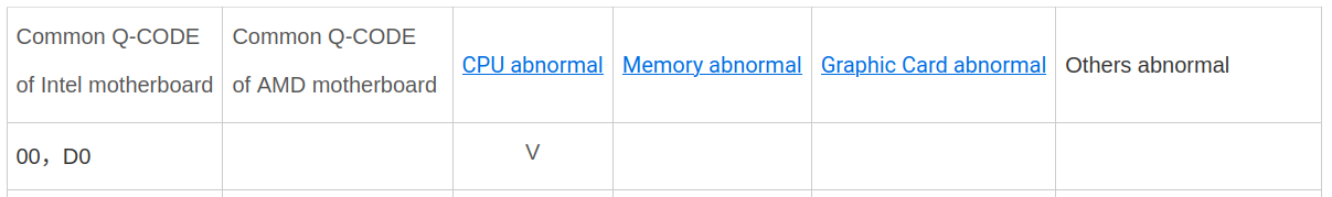

Hello. My TrueNAS motherboard, an ASUS Pro WS W680M-ACE SE, has QLED’s onboard that provide Q-Codes. My processor is an Intel Core i9-14900K. I noticed that the QLEDs are displaying a Q-Code of “00”. In the manual, it states this Q-Code is not used, however, Asus’ website shows that this Q-Code shows “CPU abnormal”.

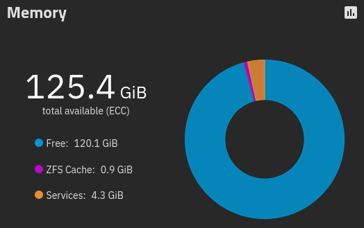

Just to make sure I wasn’t misremembering, I peeked inside the case and yep it was 00. Great board, it’s the workstation that handles Xeon chips and ECC in a certain form factor. Maxed out the ram to 128gb which the manual will say, it stops at 64 but I confirmed with a support agent first. May need a bios update but definitely takes it.
Mine has the latest and greatest BIOS versions, 4301. After I poked around in the BIOS, I did a quick recheck myself…still sitting at 00. I have 128GB of ECC memory. It’s been solid.
