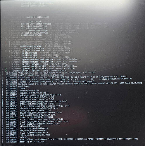

I would post an image showing the kernel panic but apparently I can’t post images or links to images. How would I show that information to the community in order to receive help?

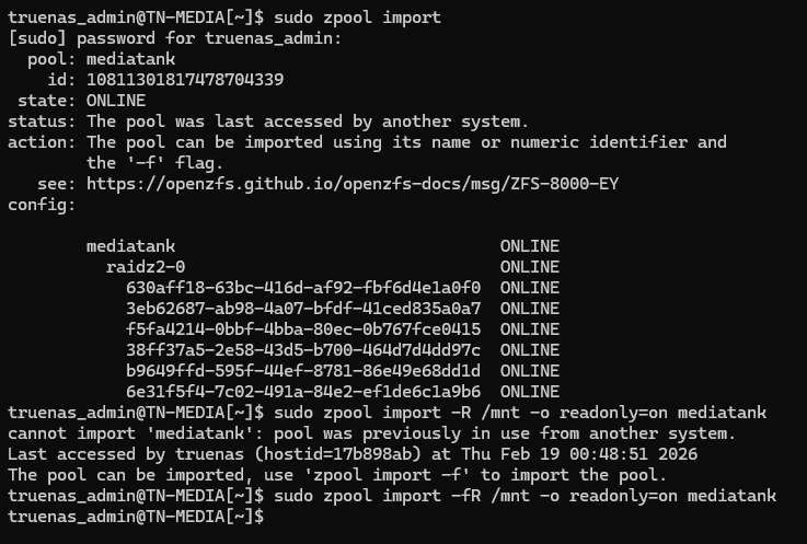

All serious ZFS troubleshooting will be from the Unix command line. For example, if you could copy and paste the output from the following command, in CODE tags, it would help:
sudo zpool import
Note that I’ve left off the pool name, as we are looking for the pool layout, not attempting to import.
You can try a Read Only import using this, but it may crash again:
sudo zpool import -R /mnt -o readonly=on POOL
Replace POOL with the name of the pool. Even if this works, it won’t the problem because the GUI / TrueNAS Middleware won’t know about the pool, yet.
Note that sudo is not needed if you are running the command(s) from user root.
Thanks, I appreciate the suggestions. The output from the two commands is visible in the attached picture. I had to add -fR because I’d imported the pool in a second instance of TN as readonly.
The read-only import works but only the root dataset is visible. There should be other child datasets. The pool “mediatank” does not appear in the storage GUI but from your post it sounds like that is expected behavior.

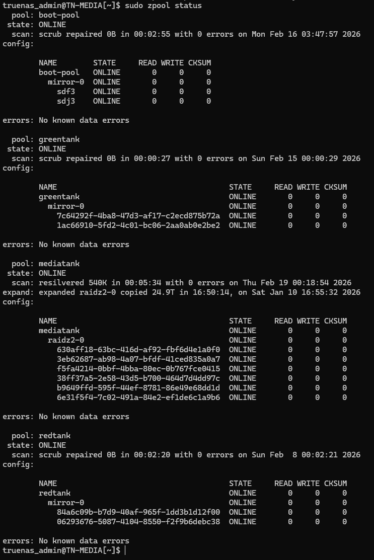

“sudo zpool status” returns:
Any further suggestions for troubleshooting, mounting or rolling back the pool would be welcome.

Well…no luck with the forced import. It just triggers the same kernel panic I was getting in the boot loop. The command to mount as read-only succeeds but the datasets I need aren’t actually mounted so I can’t recover any data. I’ll attach an image of the kernel panic in case there are any final suggestions before I move in another direction.
