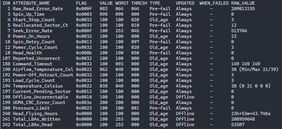

I just plugged in a new drive and immediately put it to work replacing a failed drive. Within 30 minutes I received a notice of 16 uncorrectable sectors on the new drive. Checking smart info confirmed sectors and a >0 number of read errors.
Since then it has changed it’s story, now claiming re-allocated sectors witha much higher error rate.

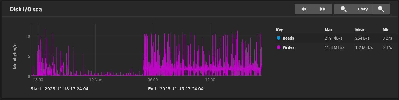

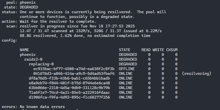

The resilver has been taking an excessive amount of time, much longer than my only previous resilver. After a full 24 hours, it is only 1.62% done, with the amount scanned sitting at 12.4T since 2 hours after start.
At this rate, Truenas estimates it to take months to complete.
Likely because the drive is writing at a max of 11MB/s…

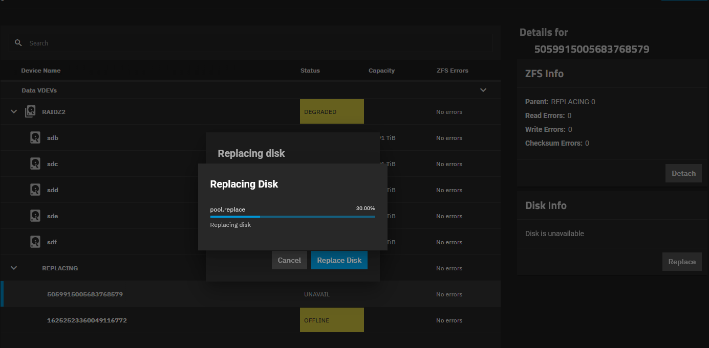

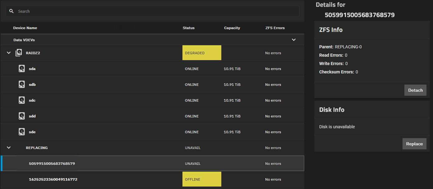

After a manual backup to be safe, I have rebooted and my pool is still working lol. :slight_smile: I have yet to plug in a replacement drive as this was sadly my only 12TB laying around.
Not quite sure what actions I will have to take when I do put in a new drive to get the resilver working again, but I am hoping it goes easy. Right now it gives me the option to detach or replace it, which both sound like ways to get where I want to be. I will figure that out when I get there.
