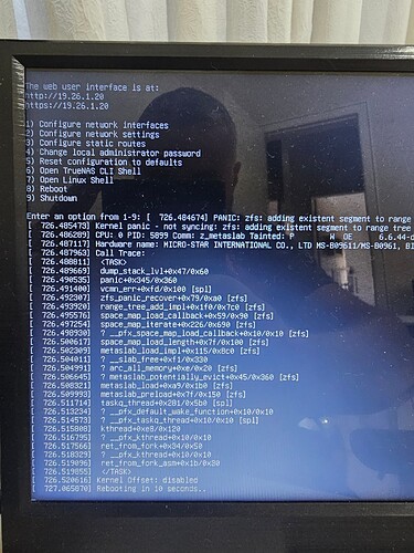

Last Sunday I had a problem with my TrueNAS pool, I was transferring a VM from my Proxmox server to a shared folder in the pool (composed of 2 4tb mirrored HD’s in an external case connected to the PC via USB-C), but I don’t know what happened that TrueNAS restarted in the middle of the transfer and since then I can’t boot with the HD’s plugged in, without the HD’s the TrueNAS system comes up without problems, but after the system comes up I plug them in again and they appear so that the pool can be imported, but when I try to import the pool again it gives a Kernel Panic error and reboots (image attached). Has anyone experienced this problem? Any ideas on how to solve it? Or will I have to format and start from scratch by making a new pool?

Thank you for your help… I ran the first command and it recovered the dataset, but in the storage tab it is empty and there is no longer an option to import the pool, accessing via ssh/terminal the folders appear, but as soon as I reboot the dataset is not fixed and all the data disappears… Is there any other command to fix the data in the storage?
Update… After importing, I ran the zpool scrub [pool name] command and got the kernel panic error… I tried the second command, but it only ran under “sudo su” and didn’t give an error, but it ran in miniseconds and didn’t make any difference, because I repeated the whole process I mentioned earlier and got the same results, after the reboot everything disappears… I have the screenshots to illustrate, but I can’t attach the forum message.
Because you are importing it readonly, and middleware is not fully aware of the pool as it’s been imported via CLI.
As you’ve confirmed it is importing readonly, run sudo echo 1 > /sys/module/zfs/parameters/zfs_recover then attempt to import via the WebUI. If that works okay, then leave it imported like that for a day or two and then after that, give it a reboot and see if all is okay.
I ran the commands as you said, but unfortunately it didn’t work, when I try to import the pool I get the same screen… With the end…

That shouldn’t be possible, zfs_recover should suppress ZFS panics and output them as warnings. To my knowledge the WebUI shouldn’t do anything to this on import attempt, but we can try purely via CLI.
Can you run sudo echo 1 > /sys/module/zfs/parameters/zfs_recover, then cat /sys/module/zfs/parameters/zfs_recover just to confirm it is set.
Then try importing via CLI, sudo zpool import tank -R /mnt - middleware should pick it up, but if it doesn’t try giving it a restart with sudo systemctl restart middlewared
I ran the commands…
truenas_admin@truenas[~]$ cd /mnt
truenas_admin@truenas[/mnt]$ ls
truenas_admin@truenas[/mnt]$ sudo su
root@truenas[/mnt]# ls
root@truenas[/mnt]# sudo echo 1 > /sys/module/zfs/parameters/zfs_recover
root@truenas[/mnt]# cat /sys/module/zfs/parameters/zfs_recover
root@truenas[/mnt]# sudo systemctl restart middlewared
root@truenas[/mnt]# sudo zpool import TrueNAS-Lima -R /mnt
After this last command, Putty crashed and the TrueNAS screen displayed the same error.
