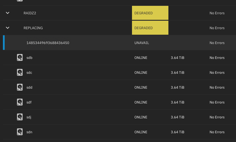

When I expand the array I see

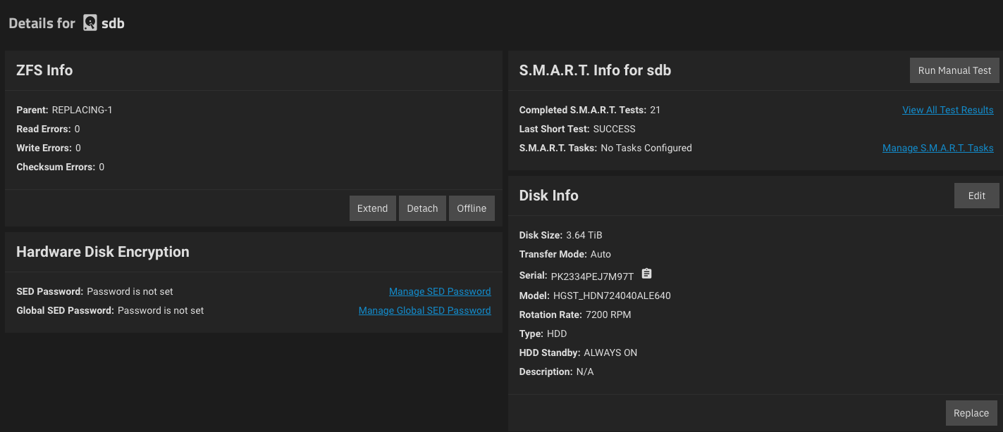

Disk sdb shows options Extend, Detach and Offline
Does this mean that some point I may have swapped a fresh drive in before offlining the faulted one or done something to convince the array there should be something there that isn’t - I see 12 drives in total (2 x 6) as expected?
The numbered drive shows options Detach in the ZFS Info section or Replace in the Disk Info section of the UI for Manage Devices. All the other devices seem fine.
Can someone advise the correct course of action here?

The UI for each of the drives is thus…
I believe the array should be fine - all the original drives are present and unfaulted - but the system seems to think a drive is being replaced. Can I just detach the numbered drive? There are only 12 HDD drives connected and only ever were as that’s all the connections I have available.
