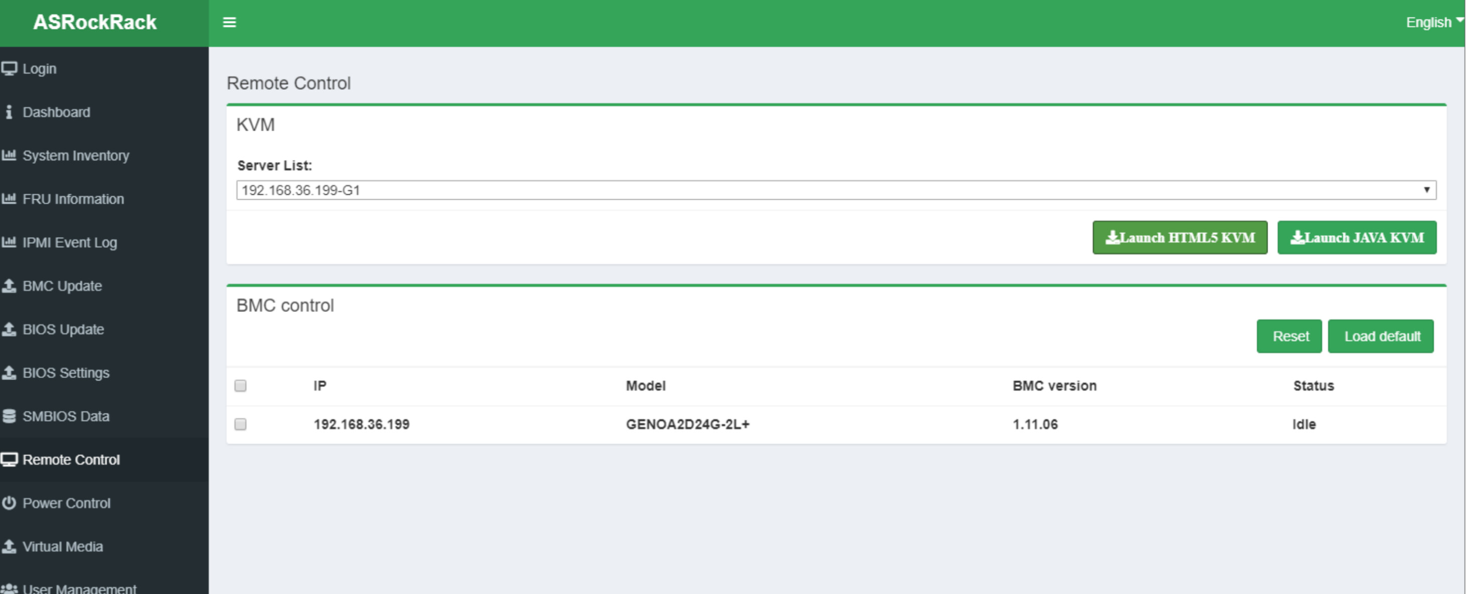

Under maintenance there are options to update Firmware and Bios. But I don’t see one for updating from an ISO. There is a place for media and also a KVM setting but am not clear how this is all supposed to work.
Can someone help navigate me thru my blackhole problem?

Check the remote control section of the manual.
Launch html5 should allow you to work on the server as if you are sitting in front of it.
Regarding the updating, download the iso, write it to a usb stick and boot from that stick to install it (while being connected to the server via html5) should work, but there are probably other ways. It should be possible to mount iso via the ipmi.

Are you quite certain about this? Because I’m 99+% sure the Mini still has a VGA port. And while you can certainly do the upgrade via IPMI as has been discussed so far in this thread, that would make it unnecessary to do so.
I just looked and checked the docs and yes it does. I either never realized that or had forgotten it. and I even found an old VGA cable and think my oldest monitor still has a VGA port on it, surprisingly. So it looks like the iKVM via HTML5 is part of the IPMI? So if I have a monitor, then use IPMI to run KVM I can run the system like a normal computer getting upgraded?
Yes.
If you have a monitor, there’s no reason to use IPMI at all.
Download the iso to a computer.
Write it to an empy usb stick with rufus, balener etcher pi imager whatever. It has to be bootable.
Plug a monitor keyboard mouse to your mini and plug in the usb stick.
Boot from the stick and install truenas on the boot drive of the mini. unplug an let it reboot.
Look which IP it has and than connect via another computer with the gui.
From the gui, import your configuration file, which you have downloaded before you startet the whole process of course.
For safety reasons, you could unplug the data disks so you do not accidently pick the wrong drive to install on.
