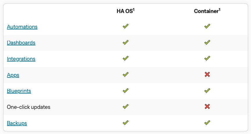

That hard constraint of no support for anything but HAOS is not on their website anymore or maybe I hallucinated it in the first place.
Still there are some unsupported features when running in e.g. Docker:
No Updates from the HA UI. No Apps.
And Apps is e.g. Zigbee, Thread border router, …
So yes, best stick to HAOS.

Just a question the app in truenas scale is a container yes? The apps run on docker. I haven’t had issues with running the customized container in docker.
Containers remain supported. Containers are not to be confused with core as described in the link below.
https://www.home-assistant.io/blog/2025/05/22/deprecating-core-and-supervised-installation-methods-and-32-bit-systems
