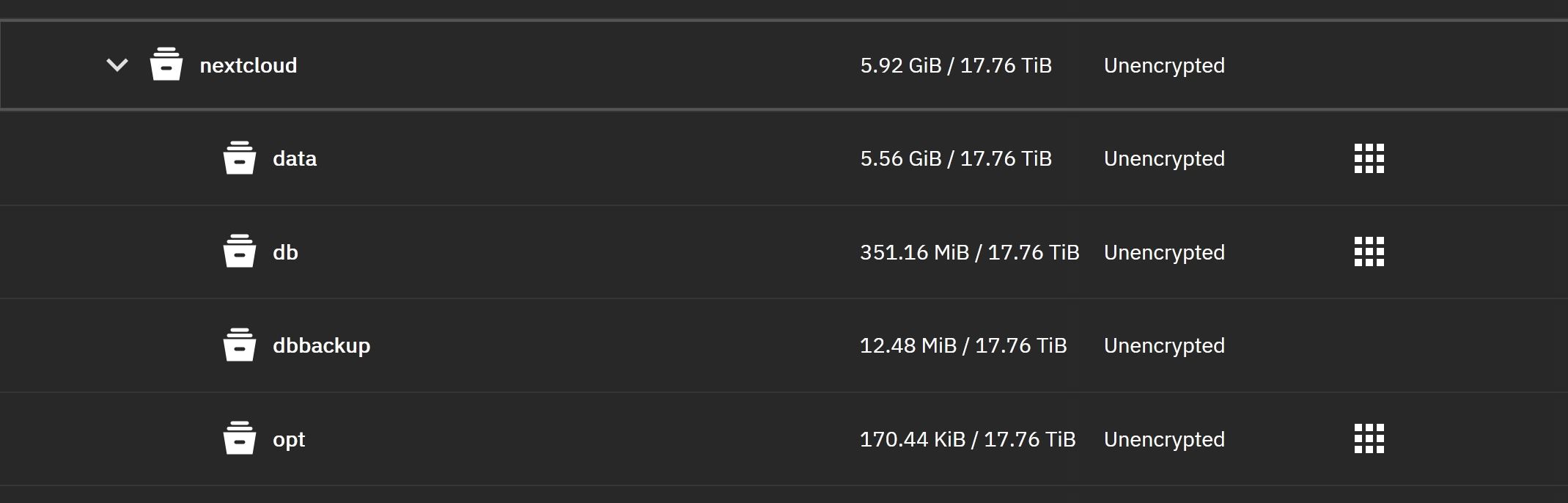

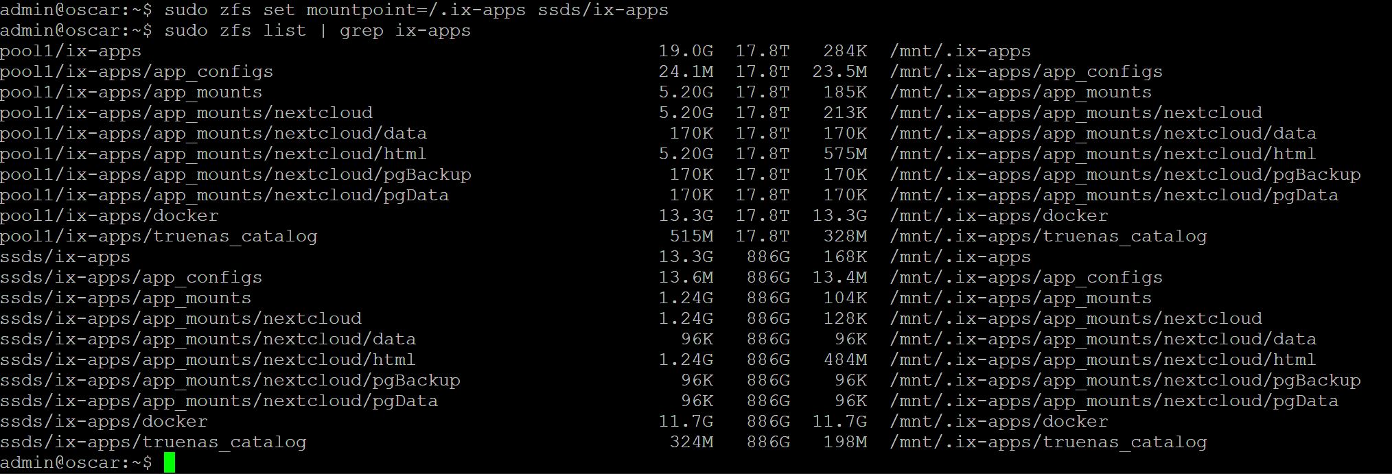

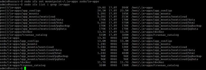

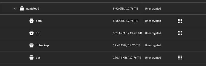

My copy from old pool (hdds) to new pool (ssds) went without issue per @Stux instructions. Thanks for that!
I’m running Truenas Version: 25.04.1
In the replication wizard, my replication found 14 “old” snapshots and I went ahead with the replication. After the replication finished, I noticed the data sizes don’t match, should they?
I chose the new pool and my app (nextcloud) works. My data still “lives” on the old pool which is the way it’s setup in the Nextcloud app GUI config.
POOL1
Am I good to go?
Also what command do I use the “destroy” the old dataset? (not going to do this just yet…)
