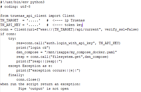

i’m using truenas_api_client:
this is an example to reproduce the exception:
this is the message in log of /var/log/middlewared.log
WARNING) websock_app.call_method():208 - Exception while calling filesystem.get(*[{‘path’: ‘/mnt/ixapps/my_docker_compose_v1.0.0.yaml’}])
@cee:{“TNLOG”: {“exception”: “Traceback (most recent call last):
File “/usr/lib/python3/dist-packages/middlewared/apps/websocket_app.py”, line 145, in call_method
result = await self.middleware.call_with_audit(
File “/usr/lib/python3/dist-packages/middlewared/main.py”, line 954, in call_with_audit
result = await self._call(method, serviceobj, methodobj, params, app=app,
File “/usr/lib/python3/dist-packages/middlewared/main.py”, line 764, in _call
prepared_call = self._call_prepare(name, serviceobj, methodobj, params, **kwargs)
File “/usr/lib/python3/dist-packages/middlewared/main.py”, line 735, in _call_prepare
job = Job(self, name, serviceobj, methodobj, params, job_options, pipes, job_on_progress_cb, app,
File “/usr/lib/python3/dist-packages/middlewared/job.py”, line 332, in init
self.check_pipe(pipe)
File “/usr/lib/python3/dist-packages/middlewared/job.py”, line 376, in check_pipe
raise ValueError(“Pipe %r is not open” % pipe)
ValueError: Pipe ‘output’ is not open”, “type”: “PYTHON_EXCEPTION”, “time”: “2025-11-06 08:31:21.479500”}}
