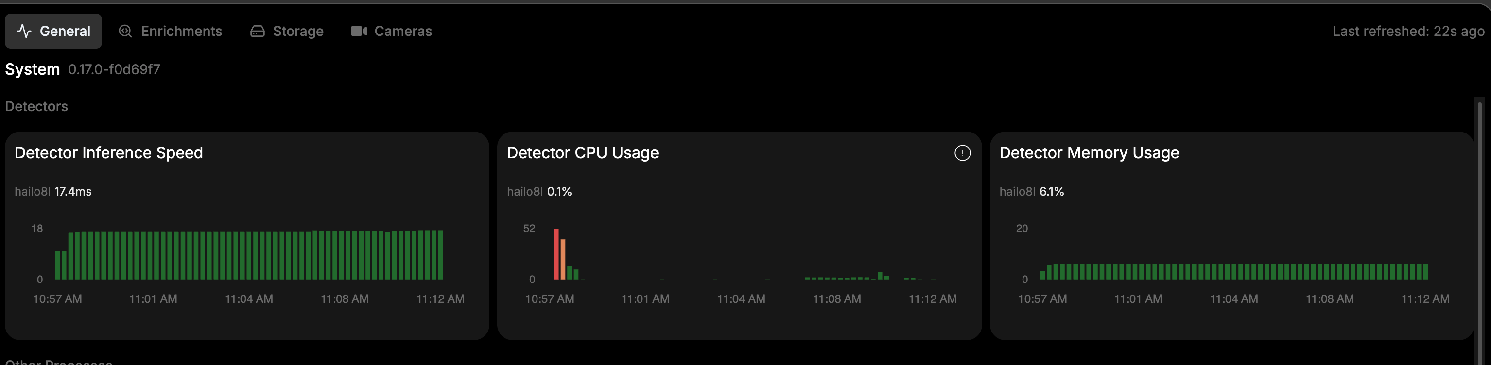

oh and this is inside my truenas VM running on PVE - but now i can use the HW natively and don’t need parallel VMs in PVE i will move my truenas back to baremetal!

Yes, please!
this is my repo, only tested on 25.10.2.1 i will be doing a 26 at some point
scyto/truenas-hailo: Hailo-8 AI accelerator sysext driver package for TrueNAS SCALE
