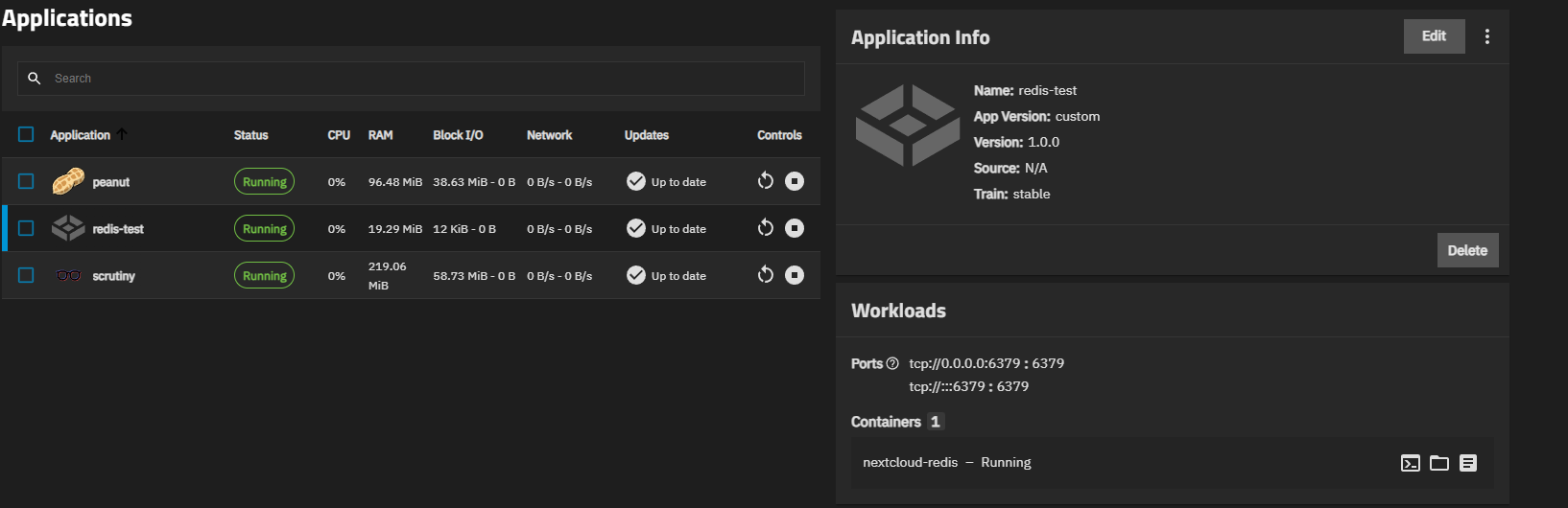

just did a test installation with the yaml i posted above and it deployed fine

ok, I made it. The problem was UID/GID 568! I fixed it via shell:
mkdir -p /mnt/app-pool/redis/redis
chown -R 568:568 /mnt/app-pool/redis
and the YAML installation is fine!
