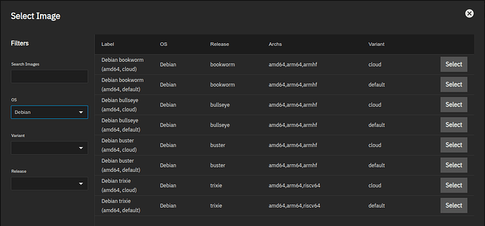

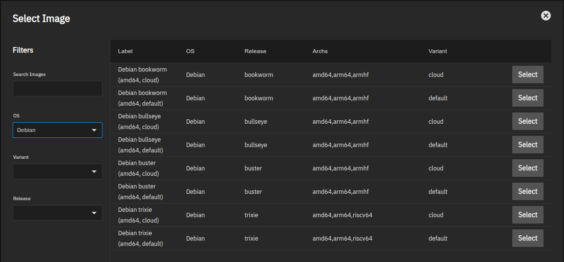

Ughh… why was support for cloud variants removed in Stable, not just Debian, all images? This is the breaking change… this removes the ability to customize easily at this point in time until these features are implemented in the UI.
Stable:
RC-1:
Log:

What is incus config for this instance? It looks like configuration was changed to something our backend isn’t expecting (possibly via incus shell commands).
The only issue I see is the variant. Only default is available when searching in the UI, not cloud. I’m using variants of the cloud-init scripts in the OP.
Everything I’ve created are with the cloud images because that is needed to use the cloud-init scripts. They are preconfigured with cloud-init whereas default is not:

I also started testing out setting up a new instance in my VM on stable and it looks like the pool name used to be default in RC-1, now it’s actually the pool name. Testing that out now…
