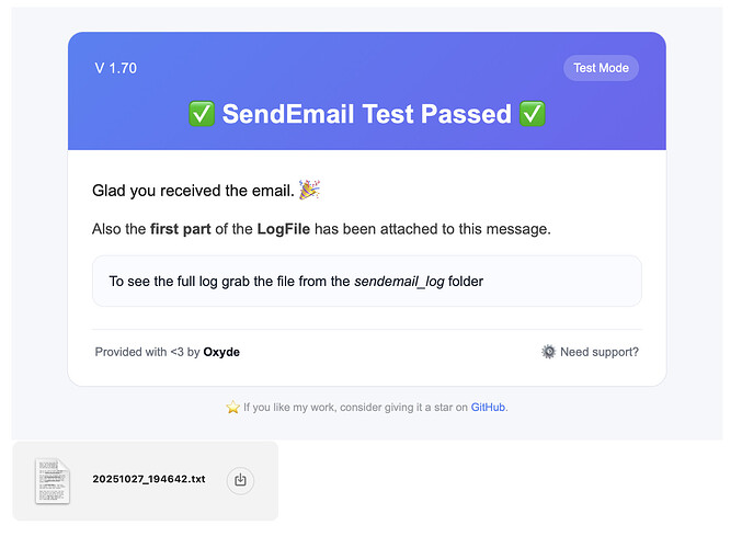

Yes, the issue is indeed caused by smtp.qq.com; TrueNAS has this problem when sending mail, but switching to Gmail eliminates the error.
Yes, the attachment was received. The email was indeed delivered correctly; it’s just that the QQ Mail error immediately triggers a “job failed” alert on TrueNAS.
Ok i have found the reason why the attachment ok count is not well displayed when sendemail treating the qq.mail exception, a small oversight my side, i will fix it in the next release. Many thanks for the “unwanted” debug :smile:

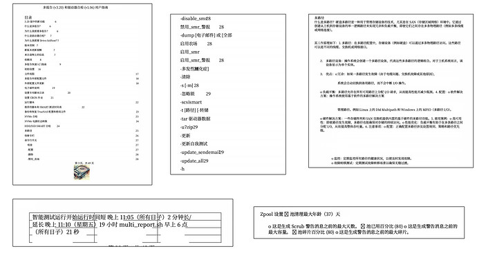

Thank you for providing the excellent open-source script. I appreciate your reply and see that you noticed the issues with search and translation.
I know that PDFs converted from Word documents are searchable by default. However, a text search that takes a second in Word or a webpage takes a considerable amount of time in a PDF. Due to the limitations of the PDF file format, the more keywords are matched, the longer the search time. I’m using an AMD 7730U laptop, and indexing any keyword takes at least 10 seconds. If searching for a particularly frequent word, the indexing time can exceed 30 seconds. Even worse, I’ve encountered issues where a keyword I searched for in Word wasn’t searchable in the PDF, so I’m not confident in PDF searchability.
The images below illustrate some typographical errors. Worse still, the translation quality is low. For the same page of text, if the translation quality using the web version of Google Translate is 80/100, the quality of the PDF translation is only around 30 to 70/100.

a text search that takes a second in Word or a webpage takes a considerable amount of time in a PDF. … I’m using an AMD 7730U laptop, and indexing any keyword takes at least 10 seconds.
Which PDF reader are you using? I never see performance this bad when I search PDFs; I’m using Okular. Something seems wrong here.
