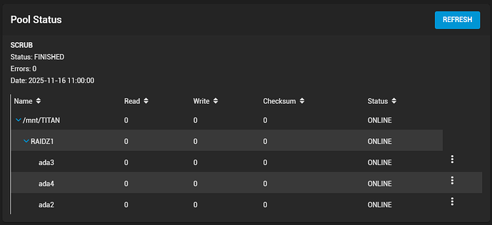

So I had a Z1 pool which consisted of 4 3tb WD red hdds, and I created a new pool of 3 10tb Seagate exos x16 and replicated my datasets to a new pool. New disks are much faster than old ones, but instead of speed boost I get a massive lag instead on reading video files. Like any mov prores with more or less high bitrate hitches massively. My old HDD in PC plays the same files with no problems. SMART shows no problems and trunas has no errors or problems on any disk.

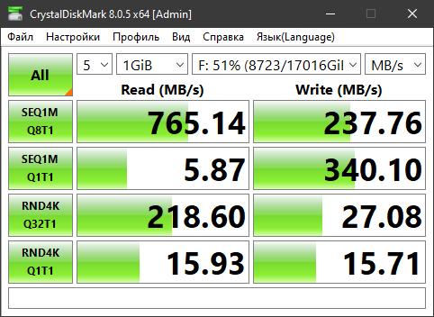

I thought maybe I have not enough ram - for best cache performance I should have at least 32gb, but I tested speed on freshly restarted system when I had empty cache and tried smaller files - I still get massive hitches on files. I edited videos from my old pool with no problem, but on this one it’s unusable do to lags. Also did a CrystalDisk test and I don’t know what to make of it.

My MB AsRock x470 Taichi Ultimate. Disks are connected directly to mb sata ports. Disks are also sata, not SCSI. I encountered no problem with copying yet. Maybe slower speeds on image sequenses, but I think it’s to be expected with a lot of smaller files through network.

One more detail and IDK whether it metters or not, but when I migrated my dataset from old pool to a new one, I did a trick when you create new pool with 3 disks, so you can make it raid z1, and then I switched one disk off. I needed to do it like this to have enough sata ports for two pools in the same time. 2 satas for system ssd’s, 4 satas for old pool and 2 satas for new one. After I replicated old dataset to new pool, I unplugged old pool, connected 3rd disk to a new one and did ascrub. Maybe there is some other thing I need to do for files to get reshuffled between disks or something like this?

further, with your “trick,” you effectively created a degraded 2-wide RAIDZ1 and then filled it with data.
In that state, read performance is basically single-disk speed…, because ZFS has only two disks to work with and must reconstruct blocks that belonged to the missing disk.
Even if you later bring the missing HDD back online, TrueNAS (or ZFS) will NOT automatically rebalance the data across all drives.
The new ZFS “rewrite”- feature (which can force rebalancing) is not available in TrueNAS Core, since Core runs an older ZFS version.
