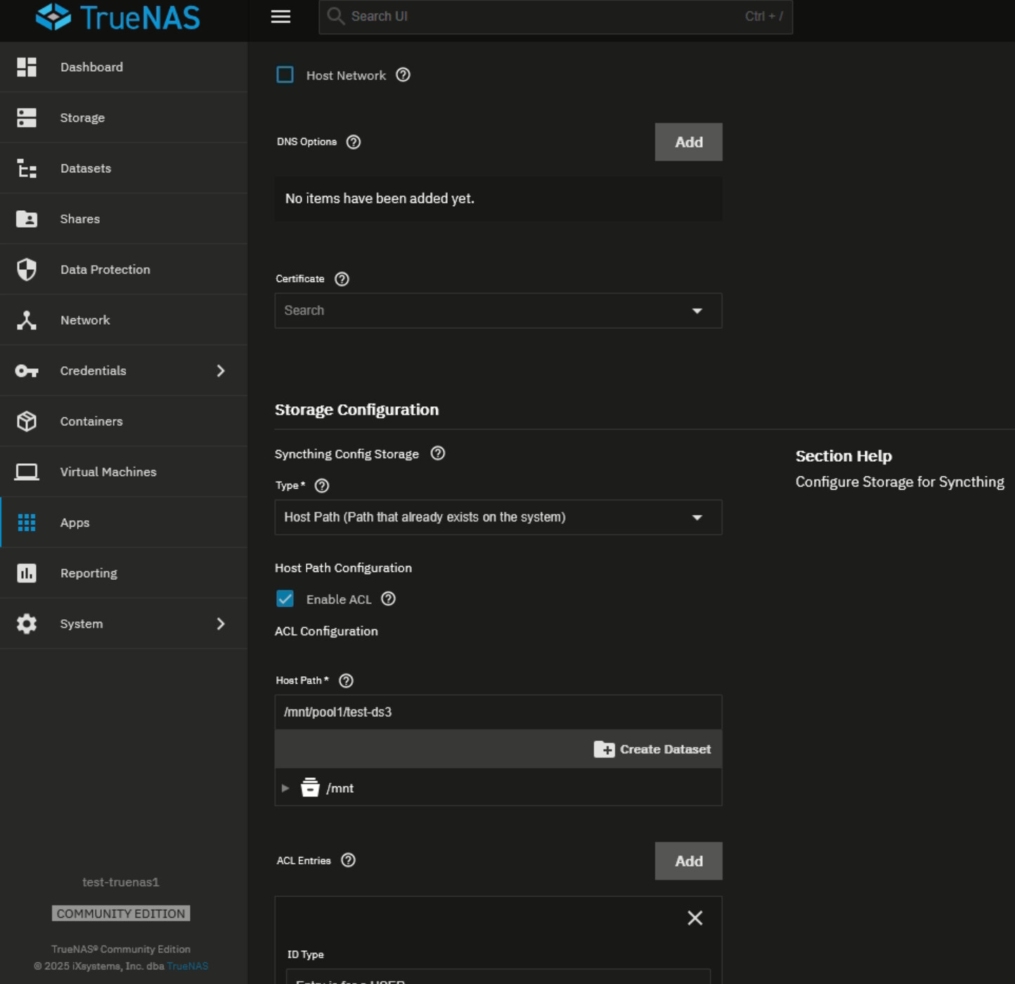

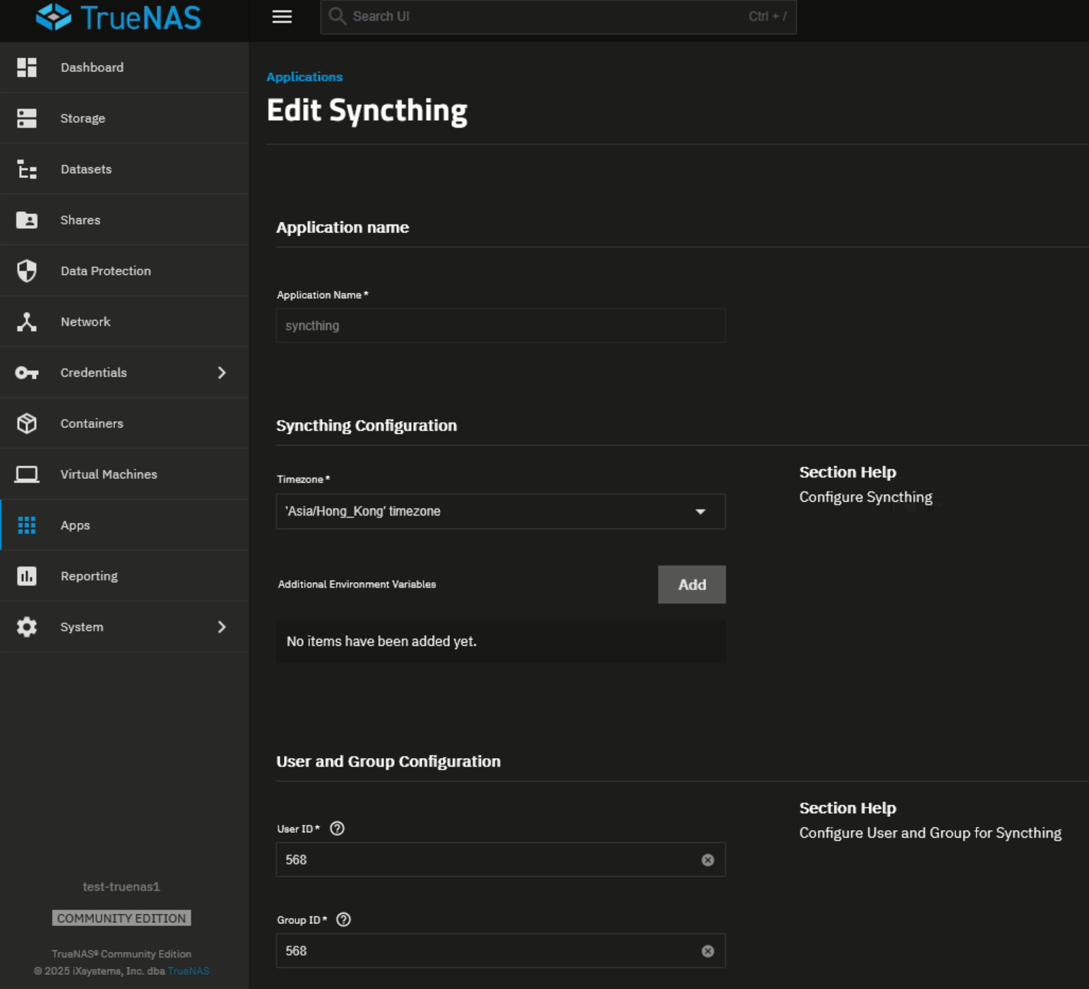

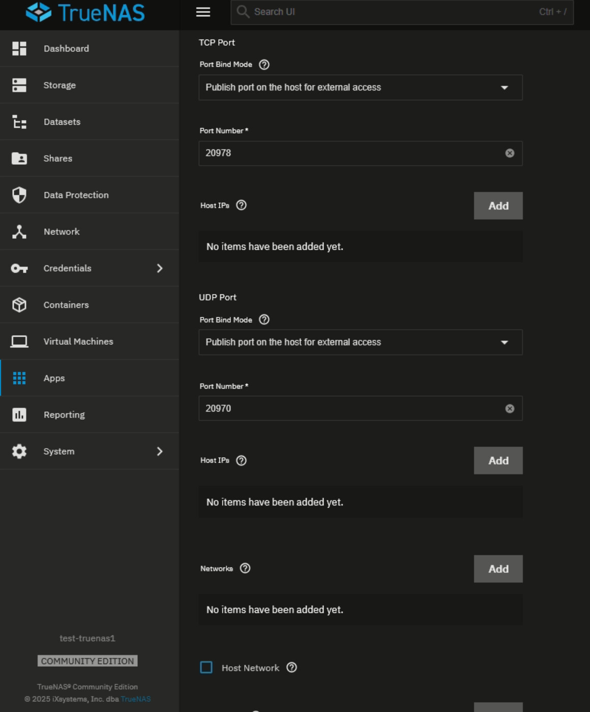

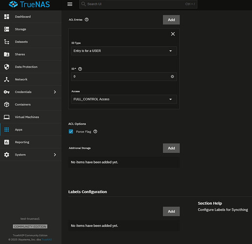

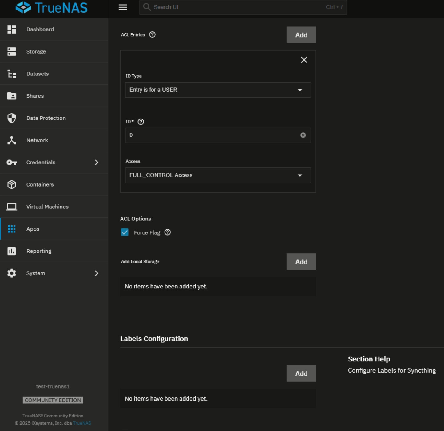

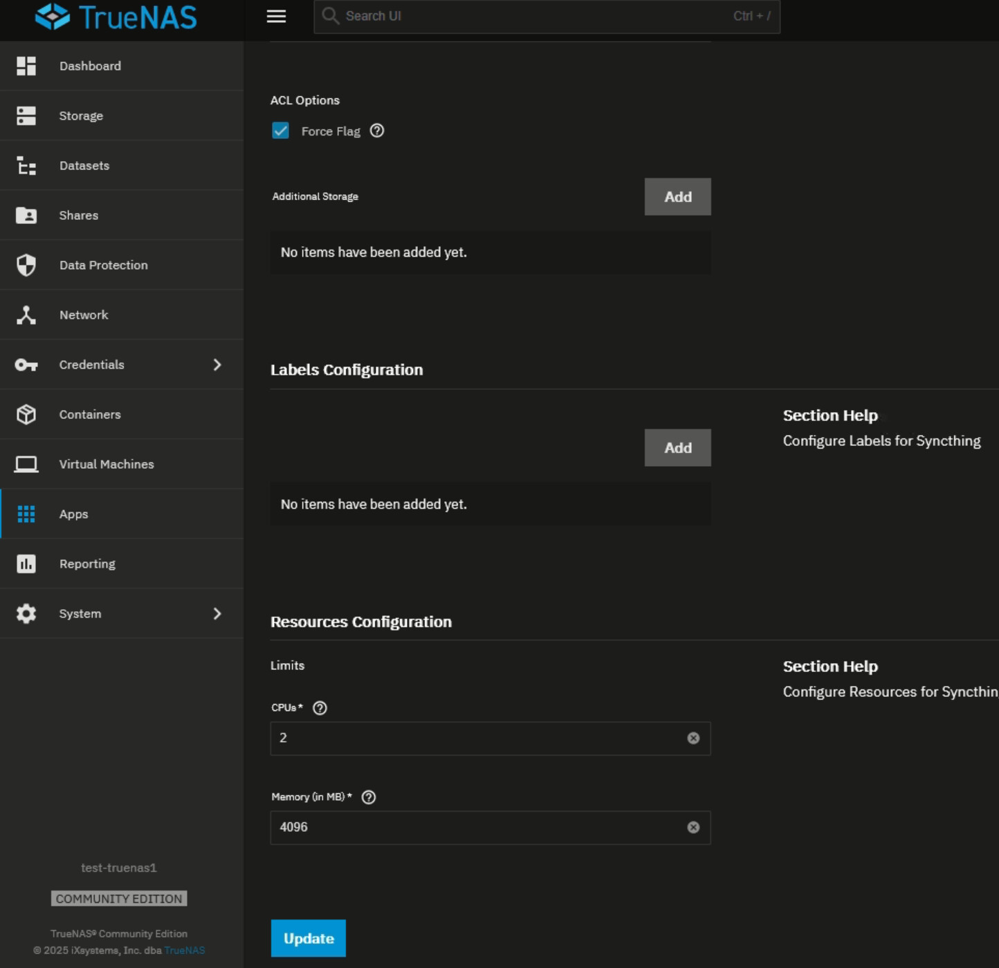

If you can post pictures of your app config, especially of your storage config. My guess is that you either did not map the storage correctly, or that permissions are wrong and you can’t see the data.
Yes, I can upload the photos to show the configuration as follows.
well you only created a hostpath for the config, but did not map additional storage to the container. It’s no wonder it can’t see anything…
You skipped the step of adding additional storage
