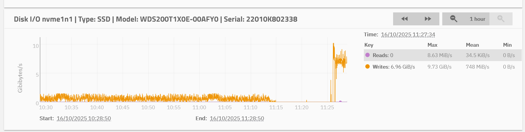

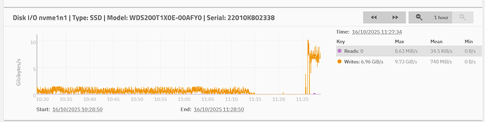

NVME drive getting thrashed despite not being in any pool

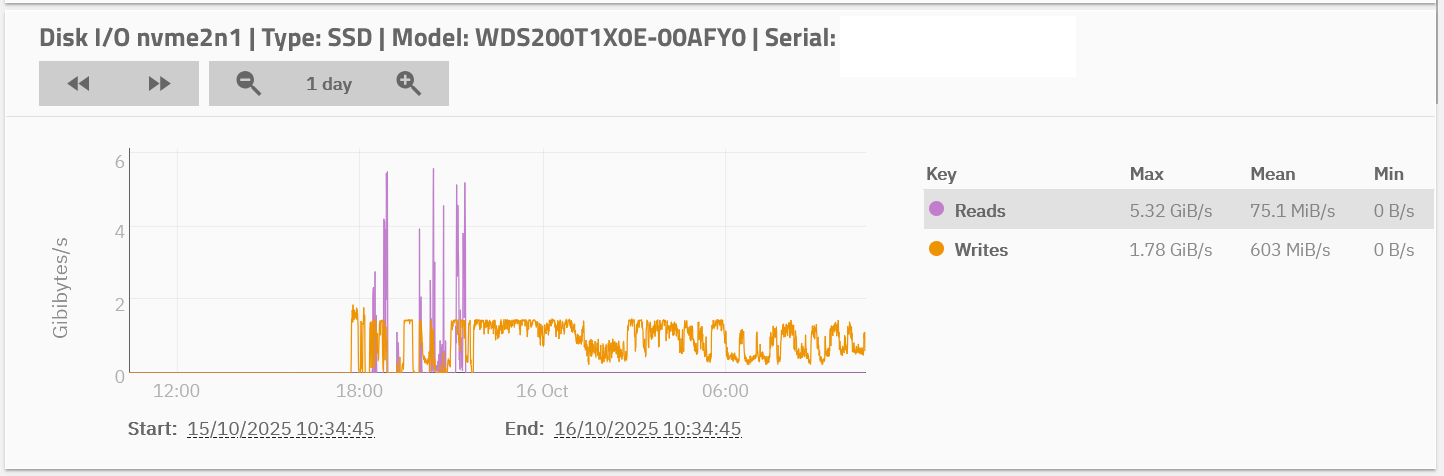

I’ve just put together a new system (25.10 RC) and have a spare NVME drive not assigned to any pool. I noticed that it’s consistently getting writes hammered at it. My TBW has increased by 3% overnight (it’s a consumer grade NVME), it wrote approx 50tb to it.
I can’t find any process in htop or iotop that is causing those writes but the reporting screen agrees with the SMART data showing it’s getting some mega writes.
Restarting hasn’t solved anything so I’ll remove the drive until I can find the reason as I’ll not have much drive left by the end of the week!
Update… after secure erasing the drive in the BIOS and then restarting, it’s now writing at 7GiB/s which is the limit of the drive. My calculation suggests the drive would be cooked in about 30hrs.
Further update… I shut it down for 20 mins and then restarted, since it’s not written a single bite to the drive (verified via SMART) which agree with the GUI report. I also noticed that CPU usage spiked highest during the fastest writes above, although I didn’t catch what htop/iotop was saying during that period.

Hence my post… I confirmed the behaviour was still occuring after wiping the drive to be sure. It 100% wasn’t assigned to any pool at the time of the screenshots.

There was nothing about drive activity in the UI graph for that drive?
