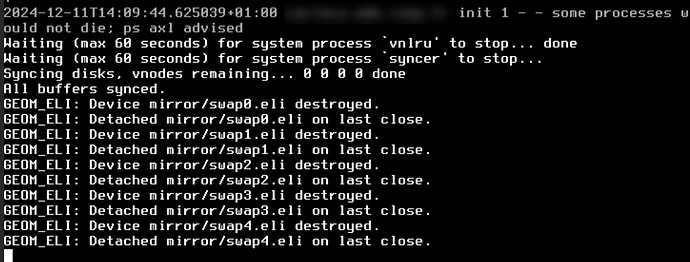

Hello, on my TrueNAS Core I have a problem I missed: since one week my periodic snapshot tasks where not running and it seems that on snapshot task locked. A few hours ago I tried to reboot (cleanly) the server and was stuck with that screen:
After a while (15 minutes ?) I cut the power and start again the server.
At reboot it showed many mtaslab_unload messages and seemed to be stuck. I tried some carriage returns and nothing except blank lines. I think I tried CTRL+C and boot sequence went on. But after that it seems that many services did not start (remote syslog, smb sharing for example).
