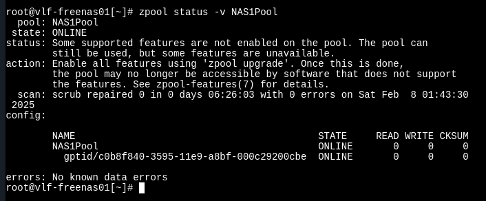

Can you supply the output of;
zpool status -v NAS1Pool
Normally if it is needed to fix something from the command line, when done, you export the pool from the command line. Then, use the GUI to import the pool.
Here is the output:

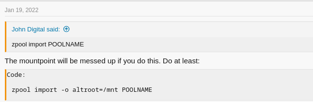

I was actually able to figure it out with the help of another thread that gave the option for chainging the mount point when importing. So as you said I exported from the CLI, and then changed the mount point to the one FreeNas was looking for with the command below in the CLI as well.
