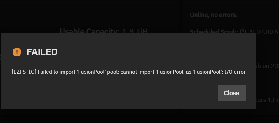

Pool won't Import
I’ve been having problems with my main pool called FusionPool. It has 2 spinning vDevs both z2 and a mirrored metadata pool. It appeared one of the nvme metadata drives was missing so I replaced, I thought it finished resilvering so I planned to upgrade the 2nd one as well. When I rebooted, the FusionPool was listed exported so through the GUI I exported the pool and tried to re-import it, which worked in the past. When I try to import via the GUI I get this message:
I have adequate disks available, with only one of the mirrored nvme drives missing.
When I go to manually import the pool via the shell I get
When I run zpool import I get the following output:
root@truenas[~]# zpool import
  pool: FusionPool
 state: FAULTED
status: One or more devices contains corrupted data.
action: The pool cannot be imported due to damaged devices or data.
        The pool may be active on another system, but can be imported using
        the '-f' flag.

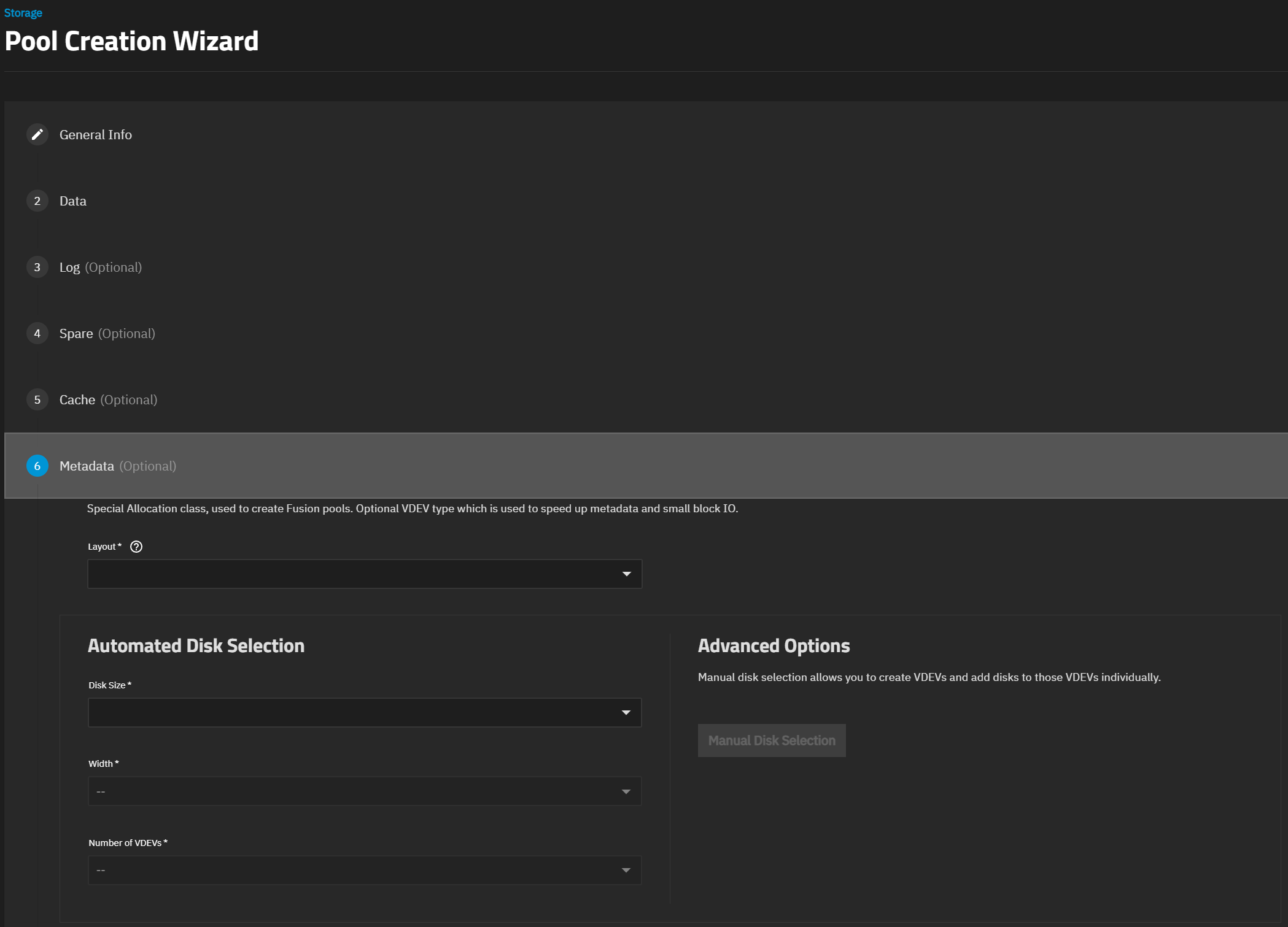

It was intended to be a special vdev, when I originally set it up. Either way I can’t reimport now.

The force flag is no required to import a pool with a degraded vdev.
The I/O error is the problem.

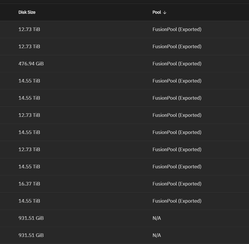

Are all devices available?
Without trying to import the pool, what is the output of this?
lsblk -o NAME,PARTUUID,SIZE,MODEL,PTTYPE,TYPE,PARTTYPENAME

root@truenas[~]# lsblk -o NAME,PARTUUID,SIZE,MODEL,PTTYPE,TYPE,PARTTYPENAME

When I originally set up this pool, it was a hybrid. I had 4 14TB in z2 and the mirrored nvme were designated for metadata via the wizard. These were set up about 5 or 6 years ago.
Prior to pool expansion, I added another vdev with 4 16TB drives. Later with ZFS expansion, I added 2 spare drives to the 4x16 vdev. Haven’t had any issues prior to this week. It started with rotating 3 uncorrectable errors, on startup, but the drive kept changing and pool scrubs didn’t indicate any issue so I ignored. If that could be creating the I/O I can disconnect that drive.

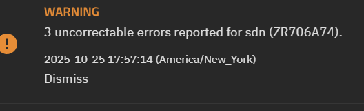

Errors reported where? From SMART or ZFS? Was it for a spinner or the NVMe’s?

Your output makes it look like you added 2 NVME’s as a data vdev in a two-way mirror.

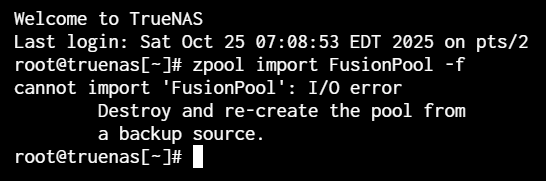

To verify, you tried this command which results in the same I/O error?
zpool import -f -R /mnt FusionPool
First, thank you for your help on a Saturday, I really appreciate it. I’m trying to download all my critical data from a cloud backup to a local external drive in case I can’t reimport this pool. I don’t keep backups of the media but it’s replaceable.
root@truenas[~]# zpool import -f -R /mnt FusionPool
cannot import 'FusionPool': I/O error
        Destroy and re-create the pool from
        a backup source.
The error is for a spinning disk, it shows up in alerts on reboot
If you think it’s related to that I/O error I can try disconnecting that drive and importing the pool. I shuffled all the nvme drives but that didn’t resolve the I/O error.

I hate to say it, but it looks like you cannot import your pool, even if you tried an emergency import with -F.
A TXG that is lagged by over 80,000 is ridiculous.
I don’t know what happened to your other NVMe or how you ended up like this. Where is the other NVMe? What do you mean by “shuffling” your NVMe’s around?
@HoneyBadger: Is there any hope?

root@truenas[~]# for dev in {f9a95cd1-86c4-4c2d-bef5-01e020f29abd,\
a88e61ec-82c2-4255-92b0-298de1335798,\
bebea15b-3341-4c5a-8cb5-2a04b726e64e,\
8d3a4f69-a526-4bf0-ae6c-efc851d43bfe,\
5b712775-ed2d-46cf-81cb-1936a6f27936,\
a34b923d-b7ff-4aca-98e9-ef7ef22d28c7,\
840bed05-be73-4e33-95bf-7d0374c1a70e,\
ef1bf023-d6db-438a-b9d1-7d2bdbb2ed83,\
8e9793b2-8d5f-4fcb-9aef-2012536184e8,\
63599f5d-7f6a-4f42-99ce-64517c6984ef,\
4cb91005-5dc1-453e-942f-5ad6ecdddefe,\
do zdb -l /dev/disk/by-partuuid/$dev | grep -E ^"    "txg;
done
    txg: 23803623
    txg: 23803623
    txg: 23803623
    txg: 23803623
    txg: 23803623
    txg: 23803623
    txg: 23720432
    txg: 23803623
    txg: 23803623
    txg: 23803623
    txg: 23803623
