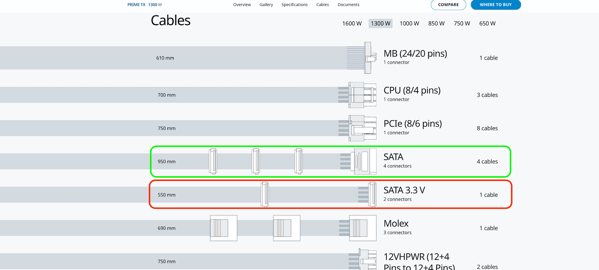

It has 4x4SATA cables = 16 SATA connectors and then additional 2xSATA cables which are 3.3V. I’m not sure if I can use these additional 2 SATA cables with HDD/SSD and whether they’ll run stable.
Just to clarify, this is the cable i’m confused with the 3.3V cables

The confusing part about this cable is that the label on my cable is “SATA 3.3”. It doesn’t show “V” which is confusing as it would seems the pinout for this cable doesn’t have a 3.3V rail (4 wires instead of the 5 for the other SATA power cable).

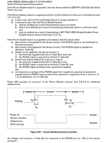

I suspect the cable tag/label is refering to SATA version 3.3.

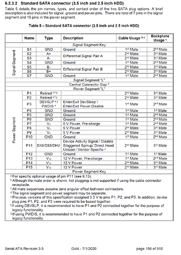

I have to dig deeper, but what I have found so far on the internet is either 3.3V on pin 1-3 or Reserved on pin 1-2 and power_enable on pin 3.
SATA datasheet is restricted to SATA members.

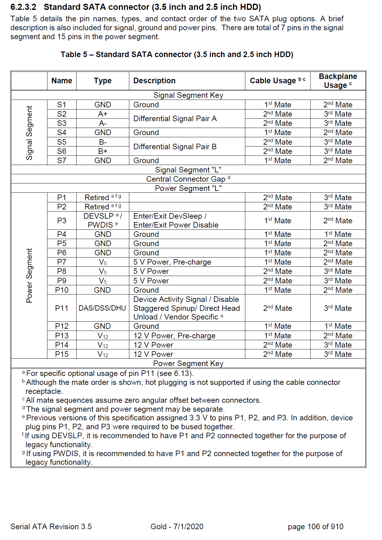

This is what I found:
The take here is that the SATA group has decided to repurpose the SATA power connector and has retired Pin 1 and Pin 2, meaning that those pins are no longer used to provide the 3.3V rail to the SSD/HDD. In the same manner, they have also repurposed Pin 3 to be used by entreprise drives as an enable/disable signaling pin (search on this forum issues reported by users chucking HDD from enclosure complaining the drive wasn’t powering up and found that they had to isolate Pin 3 with tape.)
