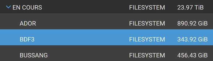

I have a dataset named “EN COURS” containing multiple dataset (one level only) for each project we work on.
all this is snapshot-ed each morning at 4am locally and replicated on the other server
Yesterday we deleted some dataset as those project were over but “BUSSANG” cannot be deleted.

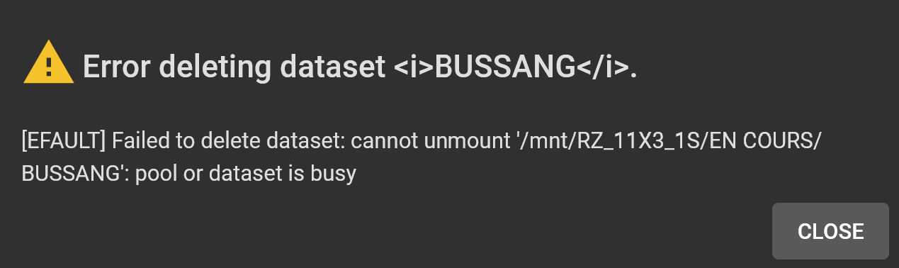

First of all it gives an error : “ Error deleting dataset BUSSANG.
[EFAULT] Failed to delete dataset: cannot unmount ‘/mnt/RZ_11X3_1S/EN COURS/BUSSANG’: pool or dataset is busy
Some other dataset has been deleted without issue yesterday but this one is impossible to delete. Maybe some file might be busy inside. It’s always a big amount of data so delete directly the dataset without emptying it as it would take ages to delete manually
