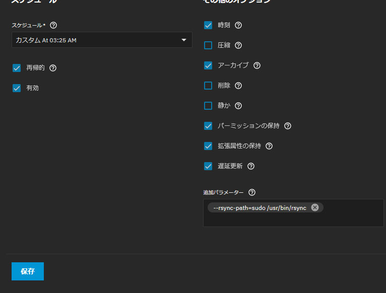

However, if I reopen the Rsync Task edit screen, the Web UI automatically splits the parameter into two separate entries:
--rsync-path=sudo
/usr/bin/rsync

  6. The Web UI now displays the original parameter as two separate Additional Parameters:
    • --rsync-path=sudo
    • /usr/bin/rsync
  7. Save the task without correcting them.
  8. The next execution fails with rsync syntax error (code 1).

I have attached screenshots showing the parameter before and after reopening the edit screen.
