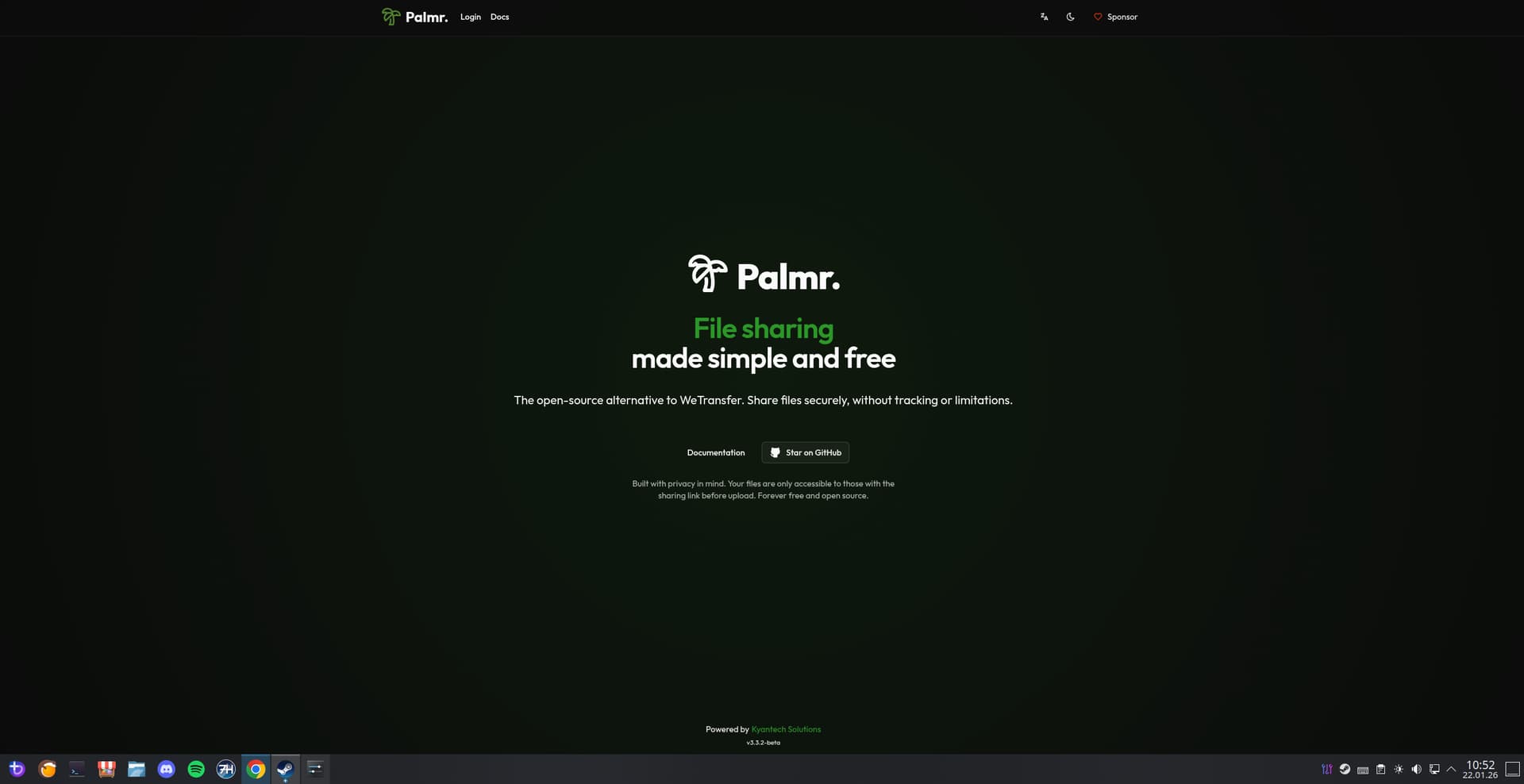

just gave it a try and got it running with the buildin yaml function.
The problem seems to be that the apps doesn’t run as uid 568 because it expects uid 1000.
But since you can’t add uid 1000 to the acl list from the truenas gui because uid below 3000 are not allowed i had to manually chmod the config folder i created.

Got it running. Set up the beta 3.2.5 via buildin YAML-function.
Here ist the YAML that works, if anybody else is interested:
