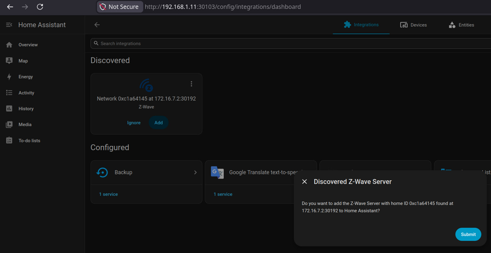

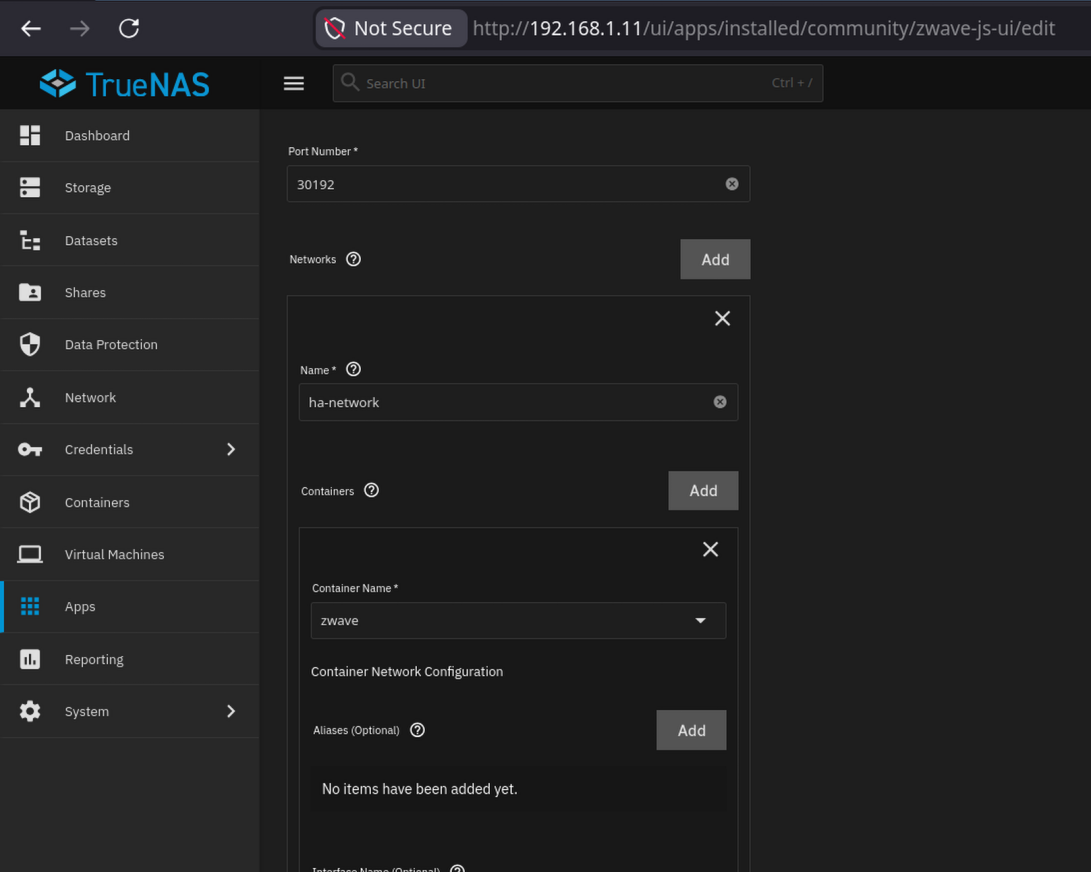

Ok, I think I figured it out. I ran “docker network create ha-network” in the shell to create the docker network. Then in the TrueNAS app config settings for both Home Assistant and zwave-js-ui, I found the Network field, and added the app to it. “ha-network” in the Name field and then the first entry in the dropdown for Container Name. It was “home-assistant” and “zwave” respectively.
After that, I went back into the Home Assistant webui’s Integrations page and saw a Z-Wave network under “Discovered”. All I had to do was click Add and then Submit. Looks to be properly integrated now, though I won’t know for sure until I get the blinds connected.

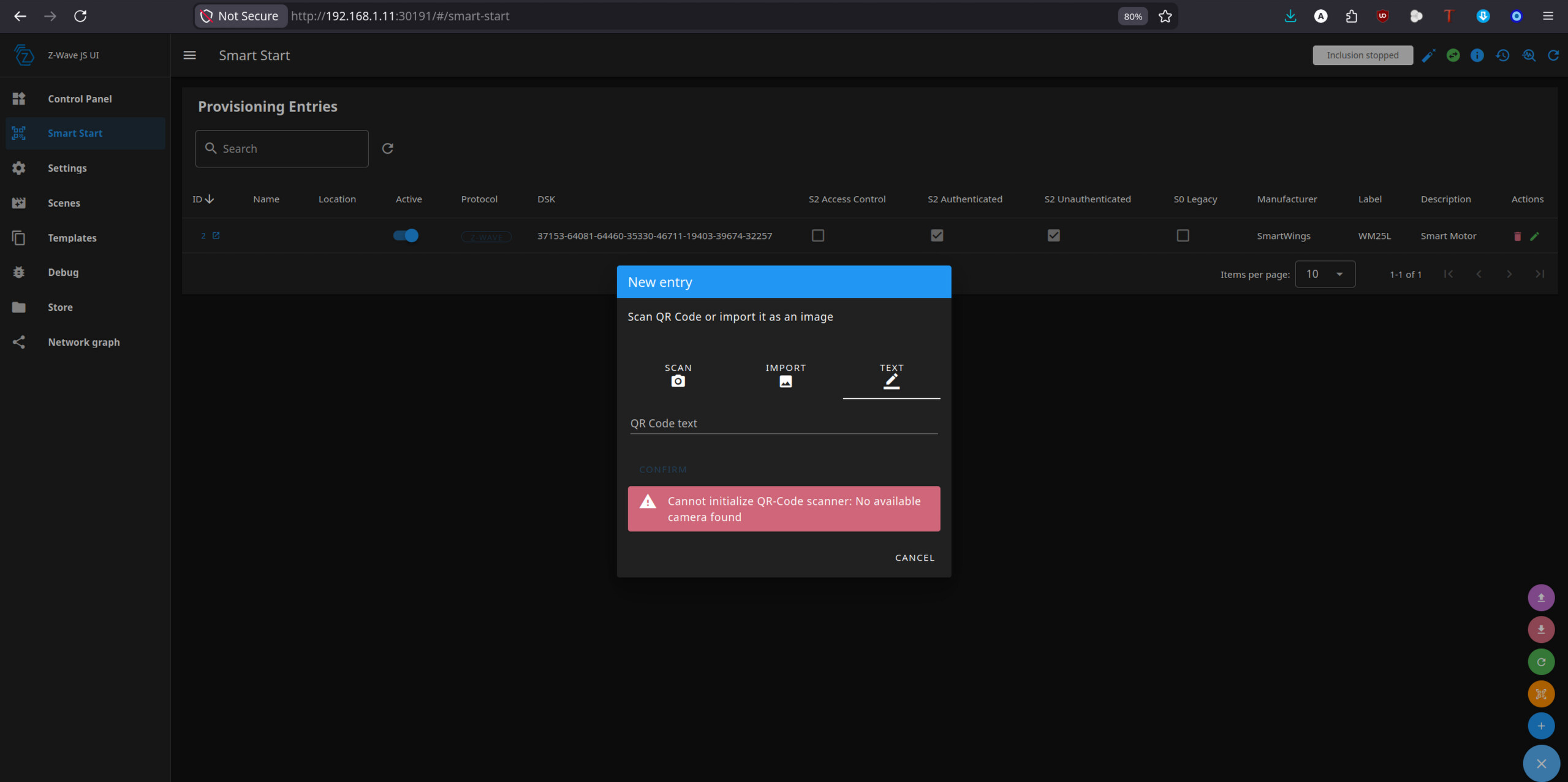

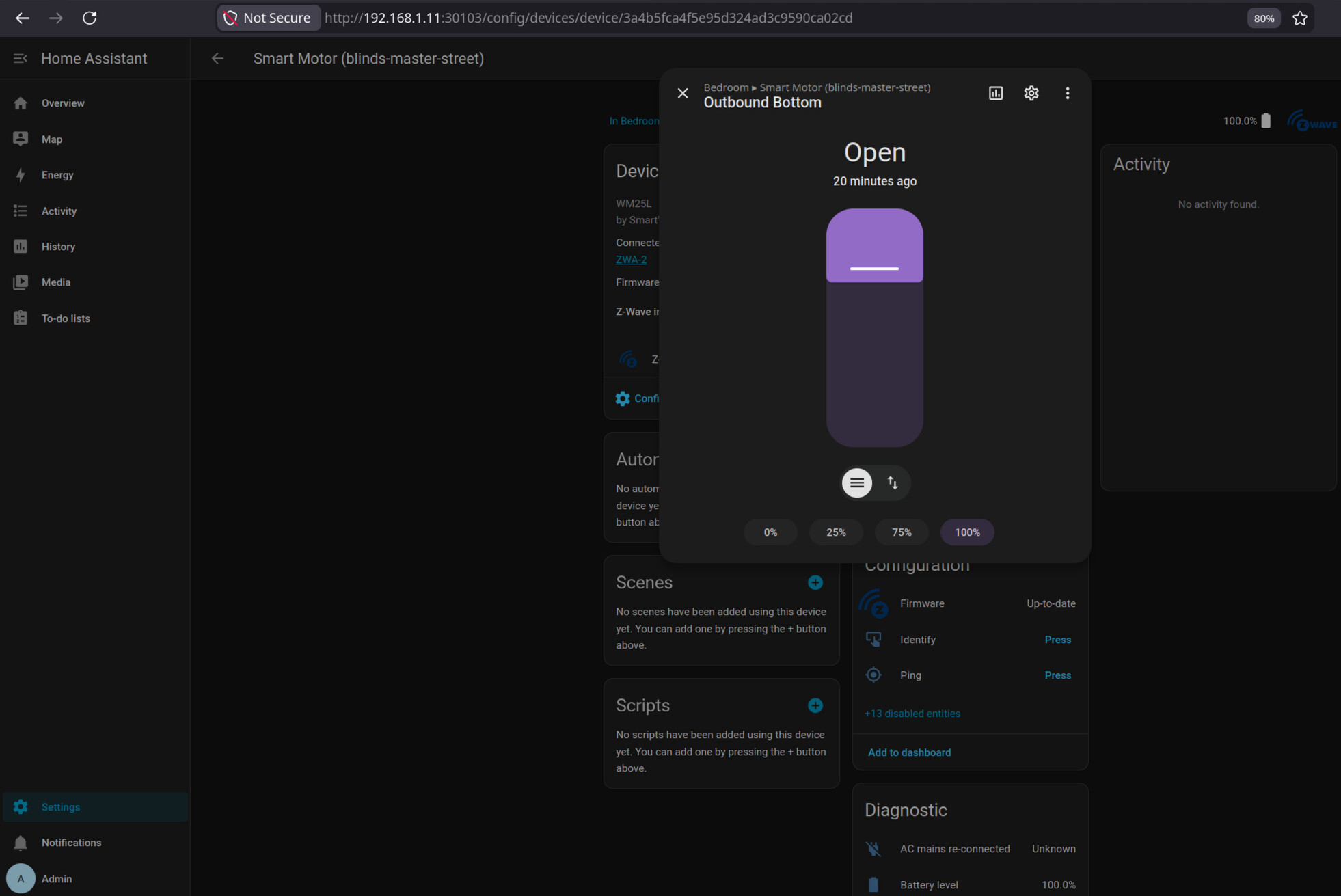

Got the first blind paired. It needed to be paired through zwave-js-ui, not Home Assistant. Just go to the SmartStart tab, hover over the magic wand icon in the top right to confirm SmartStart inclusion is active, and then use the options in the bottom right bubble menu to add the device. I opted to input the raw QR code value which I grabbed by scanning the blind’s QR code with my phone. Then just put the device in pairing mode and it should connect.
After all that, it should show up in Home Assistant.
