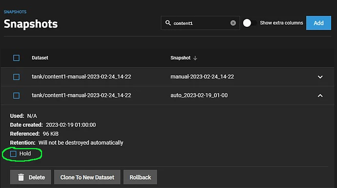

You can use the “Hold” feature to protect the latest snapshot on either side, which will prevent automatic or inadvertent deletion.

So, manual snapshot with a specific naming schema. Hold on the last snapshot and never delete it unless the next one was created and backup was done.
