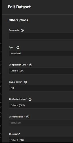

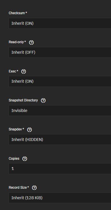

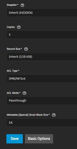

dataset photos of where folders are .
thanx
This isn’t a dataset configuration issue. Usually when people report these sorts of problems with an app, it’s because the app’s developer made a not-great choice about how to copy files (you’d think for a file management app this would be a high priority - but you’d be surprised how often this comes up).
