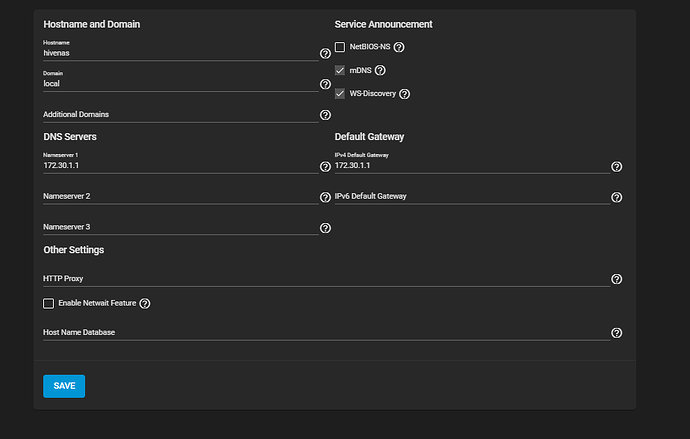

Did you configure a static default gateway and DNS server along with the static IP configuration on gb0? Maybe that is missing after you disable the interface with DHCP.
Also: don’t configure two interfaces with addresses in the same network.
DNS and gateway are set in global config.
