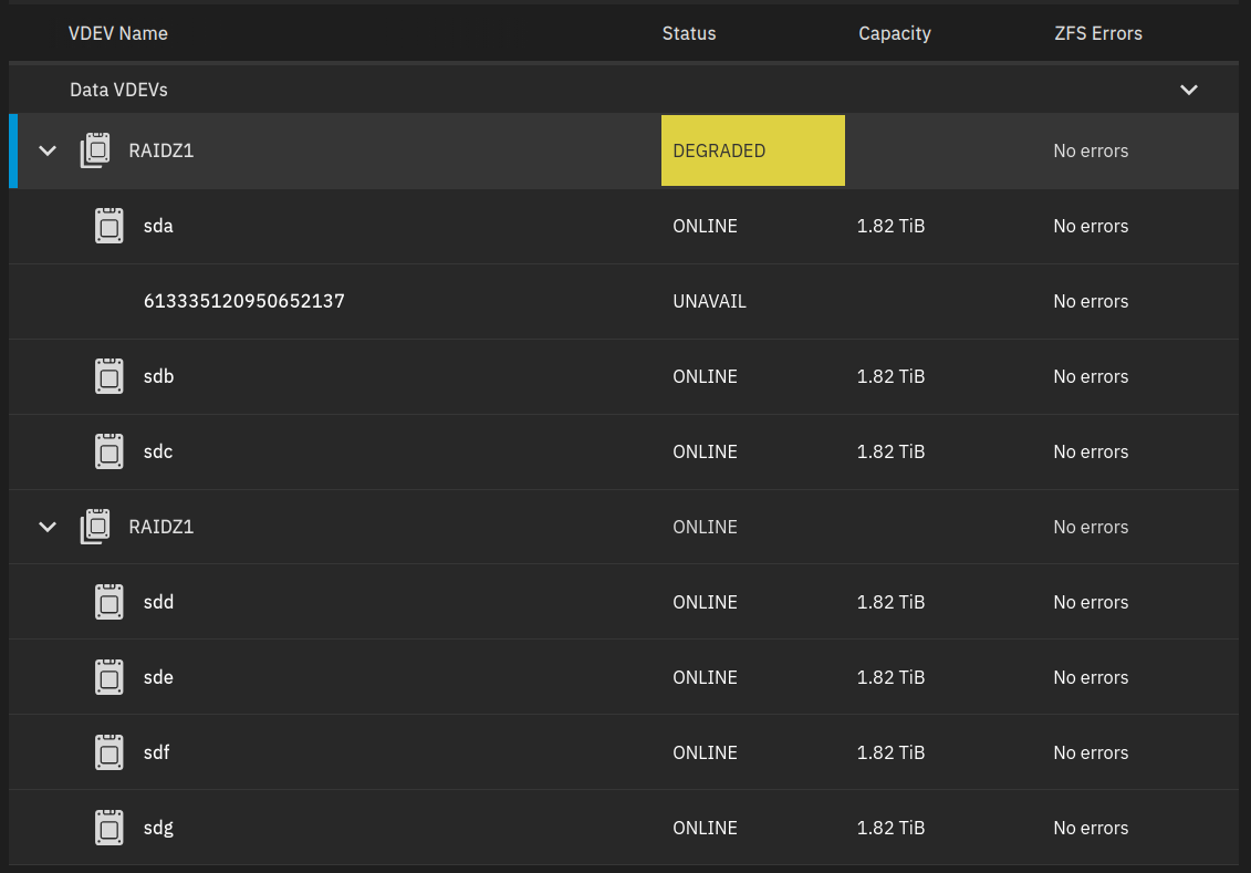

So I swapped what I think sata 0 and 1 were as the failed drive appeared to be the 2nd disk (Sata1). After I did this the pool was offline and showed a message: “Disks with exported pools” for 6 of my 8 disks, LOL. I rebooted and then the pool was online but had a unavailable disk in each vdev. Similar to before but 2 disks now.

Ok, so I put data con’s back to original locations, removed sata power splitters and used PS’s 4-way sata power. Booted up and pool is back online but with original disk showing unavailable.
So now I will start replacing data cables one at a time, as I dont think its power related at this point. The problem seems to be the same disk each time.

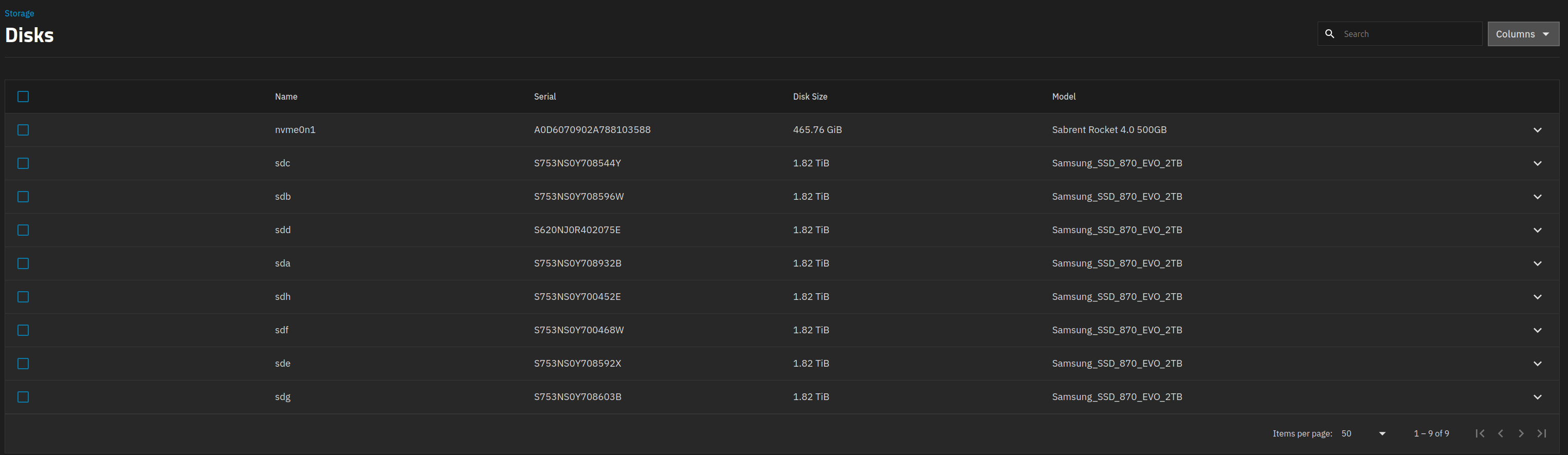

My advice, since you are dealing with RAIDZ1 vdevs, While the TrueNAS system is running, obtain all the drive serial numbers that you can read in the GUI. This will leave one drive that is not readable due to it being unavailable.
Next, power down, remove each drive one at a time. Examine the serial numbers of each drive then mark each drive in a way that you can read the last 4 digits of the serial number so you don’t go through this again.
Once you have identified the drive serial number you have not written down, then that is the drive with a problem. You can replace the data connector if desired however let me ask you a few questions:

Here is how the drives are listed for now. Is the scrub a good idea now?

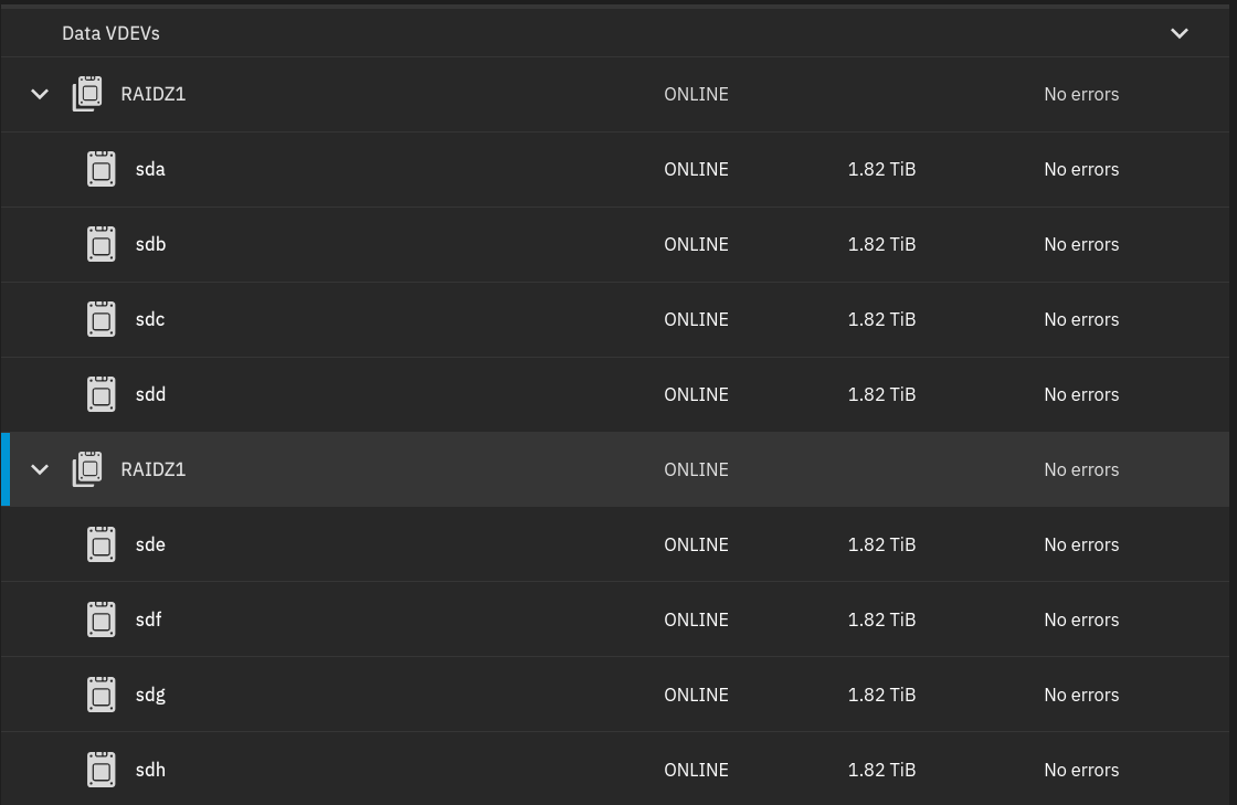

Quick update. So I ran the scrub then ran ‘zpool clear’, then rebooted. All drives are now available and no errors! I think we are good now. However I just ordered a 12 pack of sata cables from Amazon for $11. I will install these this week for good measure!
Thanks everyone for the help. I think we are good.
