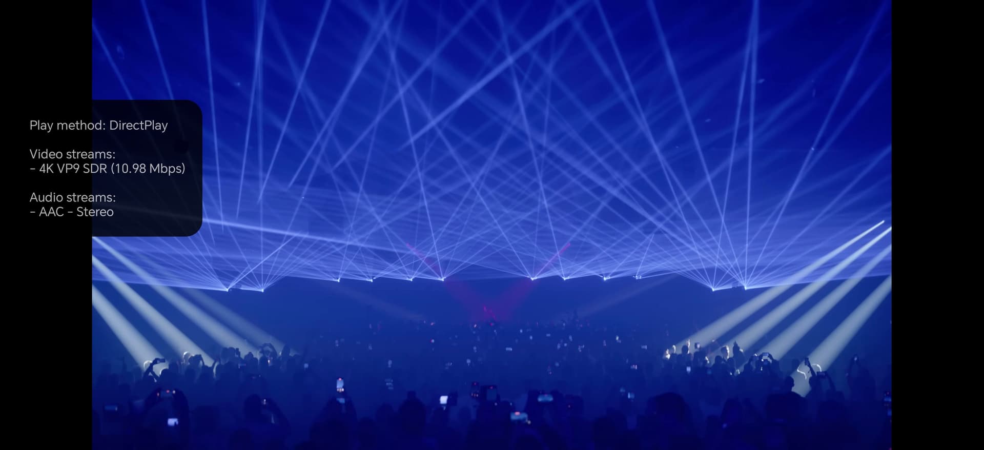

Not sure about the mobile app, but in a browser there is a setting for bitrate (which will cause the jellyfin server to transcode). You can set a lower bitrate and see whether it helps.

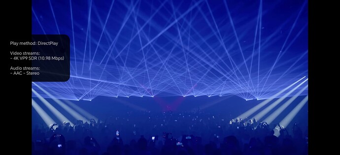

Also, there is a “playback info” option (should be present in the app as well). This info can give you a clue. Posting the screenshot also can help.
You’ve already done it. Didn’t notice it, my bad. So, it looks like a network issue.

Welp, usually there is also a dropped frames count (and some other info). Just to exclude the issue with your smartphone, can you share mobile internet with your laptop (or pc/tv/console) and play the video from the “big” device?

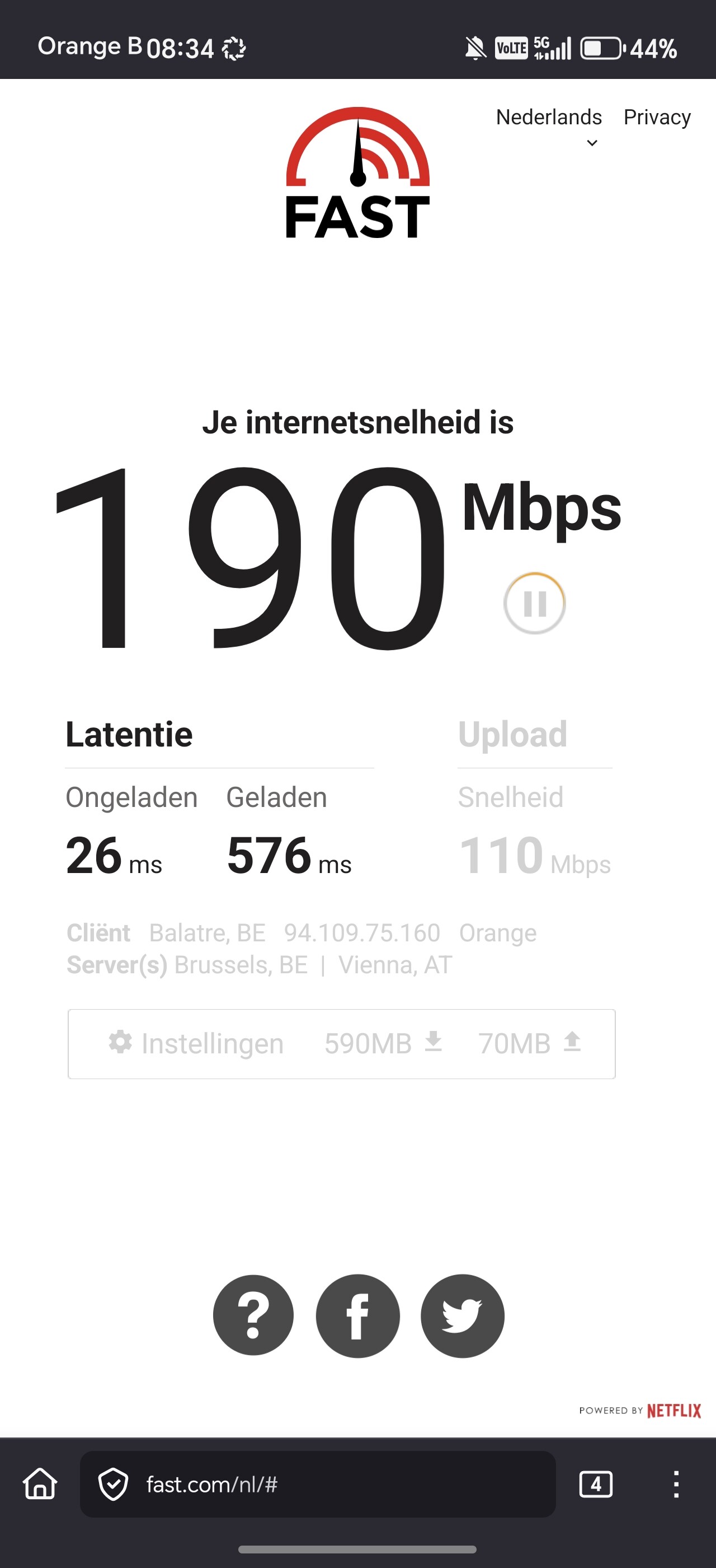

You note your download speed, but what is your upload speed, that is what matters when serving content from your network , outside of it…
If turning on a VPN makes it better, that seems weird, is this your own VPN back to your home network, or some 3rd party VPN and where do you connect to on their side? (Your own country, somewhere else…)

If could be traffic shaping on the mobile network. Not sure about which country OP is in, who their provider is, or what applicable telecom laws are present for them, but it is fairly common to have different ‘tiers’ based on the type of traffic the telecom is picking up.
Before any outrage, some of this is borderline mandatory & good; ie prioritizing emergency services.
It’d also explain why a vpn actually gives better performance.
That’d be my two cents from my experience in wireless operations if this is impacting ONLY watching streams on mobile network while all others are working fine.
Edit; ever wonder why speed tests perform so well compared to everything else? :wink:

Amber Broos FULL SET - Waagnatie 2024 - MKV
Container: mkv
Pad: /mnt/jellyfin/libs/vids/Music/DJ_Sets/Amber Broos FULL SET - Waagnatie 2024 - MKV.mkv
Grootte: 9.5 GiB
Beeld
Titel: 4K VP9 SDR
Codec: VP9
AVC: No
Profiel: Profile 0
Resolutie: 3840x2160
Beeldverhouding: 16:9
Anamorf: Yes
Geïnterlinieerd: No
Verversingssnelheid: 25
Bitsnelheid: 10983 kbps
Bitdiepte: 8 bit
Beeldbereik: SDR
Bereiktype beeld: SDR
Kleurruimte: bt709
Kleuroverdracht: bt709
Primaire kleuren: bt709
Pixelindeling: yuv420p
Ref-frames: 1
Geluid
Titel: AAC - Stereo
Codec: AAC
AVC: No
Profiel: LC
Opmaak: stereo
Kanalen: 2 ch
Bitsnelheid: 192 kbps
Bemonsteringsfrequentie: 44100 Hz
Standaard: No
Gedwongen: No
Extern: No

However when trying to stream the same content over a mobile network caused video to stutter although the bitrate is 11 Mbps where the downloadspeed of the network is 150+ Mbps.
Something that you should be aware of. Your internet speeds are usually not symmetrical. So that 150+ Mbps download speed is irrelevant because for your server to stream to those mobile devices, it uses your upload speed, which is often 10x slower. My ISP, for example, gives me 300 Mbps down, but only a paltry 11 Mbps upstream.
If you’re tunneling over a VPN or something, expect speeds to be slower still due to overhead.
Yes. I connected my laptop to the hotspot of my cellphone with the ame result. The only way to somewhat prevent interruptions, is to lower the quality at client side to 3 Mbps.
BTW: my provider gives me 40 Mbps upload.

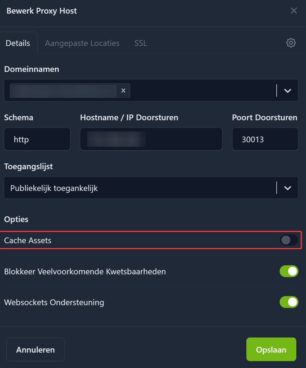

I found the solution :slight_smile:
In Nginix Proxy Manager, edit the host for the Jellyfin app: throw the ‘cache assets’ switch to OFF.
