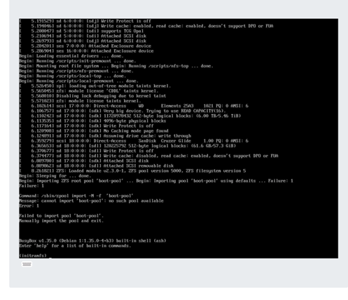

I lost my SMB folders (not accessible) and the login screen went from admin to truenas_admin. I read about permissions and followed a step by step, but everything said that my data was under root and it wouldn’t allow me to change anything. These documents are both work and personal. I restored the admin settings to default, but that didn’t change my permissions. I then created a backup of my work and personal files on another pool which is a USB external drive. I thought maybe reinstalling everything from scratch would be the next step. Well, I downloaded the latest TrueNAS 25.04.2.5 and did the install. When I got to reboot system and remove usb install drive, I did that. Now it won’t boot into TrueNAS Scale. I get the following error message.
