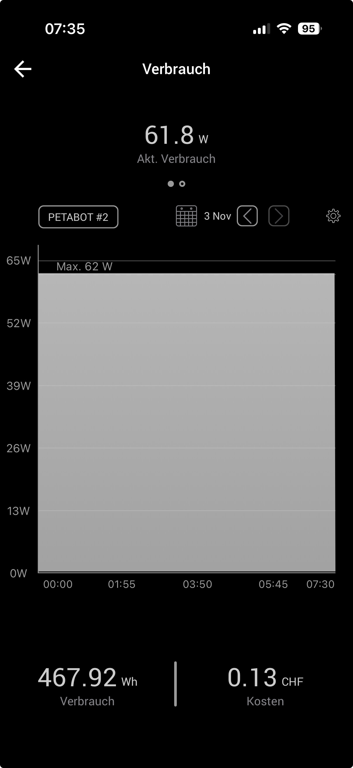

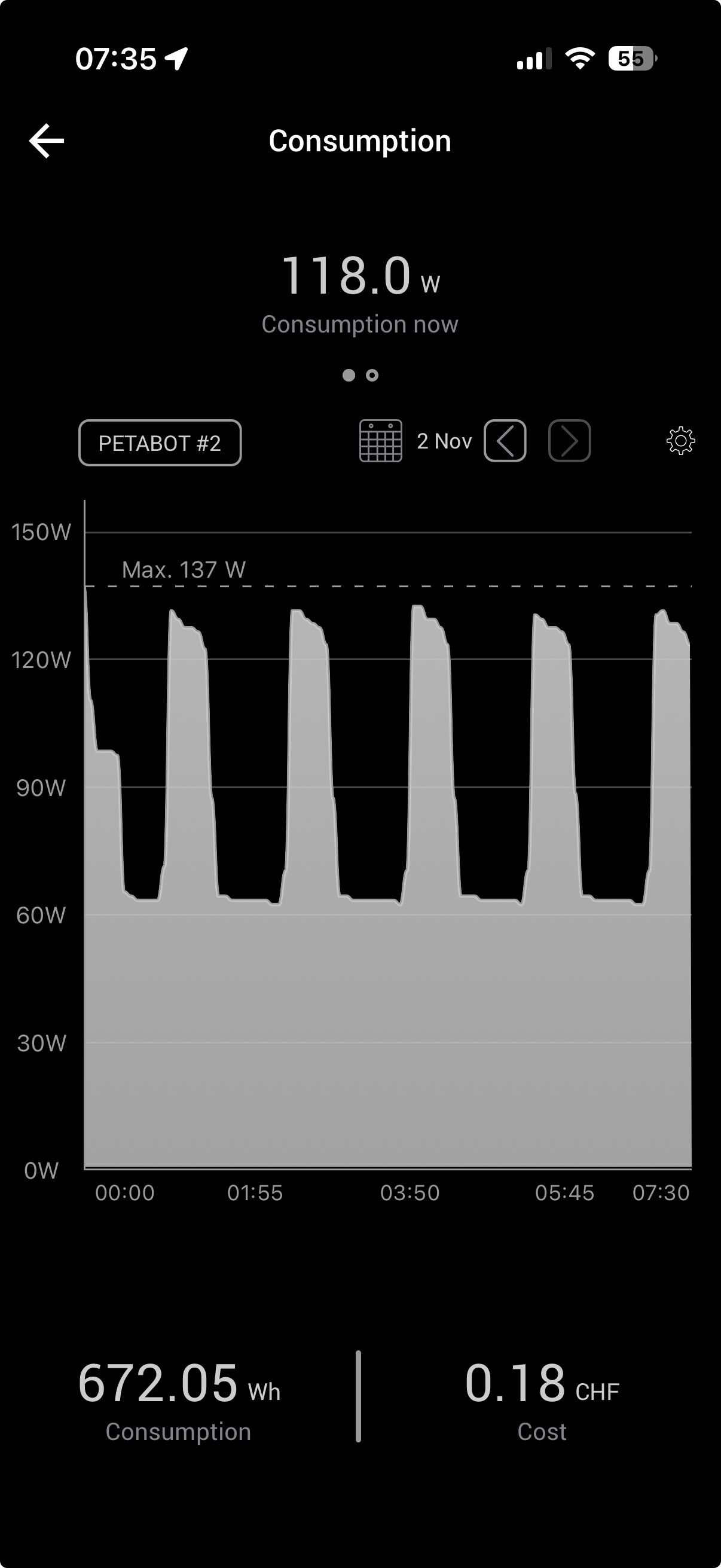

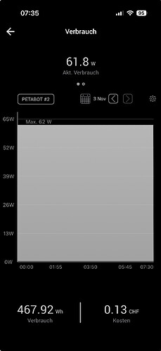

After updating to 25.10.0, I noticed that my disks wake up every 90 minutes. This was not the case in the previous version 25.04.2.1. To illustrate the behavior, I have attached a screenshot of the power consumption.
