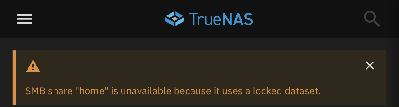

I am getting SMB share “Share Name” is unavailable because it uses a locked dataset.” after every boot on beta 2 (no problem on beta1)
However, everything works and the datasets are all unlocked.

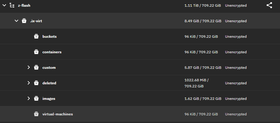

I still get the below error when starting a container.
Validation Error
internal error: guest failed to start: Failure in libvirt_lxc startup: cannot find init path ‘/sbin/init’ relative to container root: No such file or directory
Error Name: EINVAL
Error Code: 22
Reason: internal error: guest failed to start: Failure in libvirt_lxc startup: cannot find init path '/sbin/init' relative to container root: No such file or directory
Error Class: libvirtError

If I run:
sudo zfs inherit canmount z-flash/.truenas_containers/containers/Zabbix
sudo zfs mount z-flash/.truenas_containers/containers/Zabbix
The container will start but when running docker in the container and I attempt to start Zabbix I get the following error.
[root@Zabbix zabbix-docker]# docker compose --profile full -f ./docker-compose_v3_alpine_mysql_latest.yaml up -d
[+] Running 0/6
 â ¸ Container zabbix-docker-zabbix-agent-1         Starting                                                                                                                            0.3s
 â ¸ Container zabbix-docker-zabbix-web-service-1   Starting                                                                                                                            0.3s
 â ¸ Container zabbix-docker-zabbix-java-gateway-1  Starting                                                                                                                            0.3s
 â ¸ Container zabbix-docker-zabbix-snmptraps-1     Starting                                                                                                                            0.3s
 â ¸ Container zabbix-docker-db-data-mysql-1        Starting                                                                                                                            0.3s
 â ¸ Container zabbix-docker-mysql-server-1         Starting                                                                                                                            0.3s
Error response from daemon: failed to create task for container: failed to create shim task: OCI runtime create failed: runc create failed: unable to start container process: unable to apply cgroup configuration: mkdir /sys/fs/cgroup/docker/5ccd736196f480a56cef67adb651f1dfa47cfab1032c16e3616beb88e9806a4b: permission denied: unknown
The containers were running fine in 25. They have not worked sinse 26 BATA-1.
Any suggestions on where to look.

This particular container has no data sets mounted into the container.

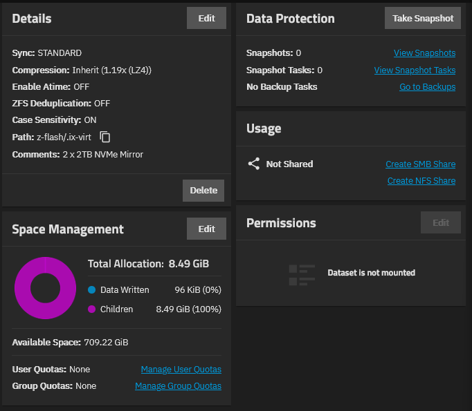

The following dataset is visible which it never was before upgrading to BETA-1
The dataset is not mounted.

After reboot of a system with encrypted datasets, a spurious alert shows in the GUI that shares related to the dataset are unavailable. The dataset is unlocked and the share is available. New beta 2 behaviour.
You can use Report a Bug and attach a Debug Dump. I can’t tell if a previous ticket has the Debug Dump attached and may get closed without. At worst, a new ticket will get closed as a duplicate
I am getting the exact same issue on Beta 2 that was no in Beta 1 across 2 different TrueNAS systems.
Everything does work though.
