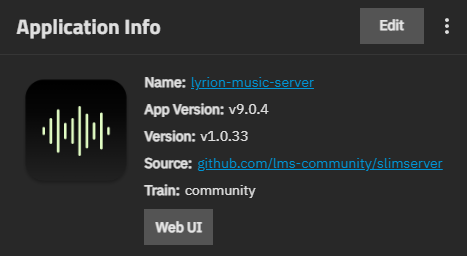

In truenas :
Now, is there possibility to add latest tag to catalog apps ? Or does it make any difference ? How are catalog apps maintained so they get updates ?

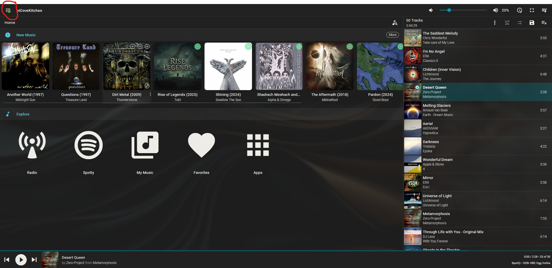

Do you have currently notification about server update in settings? :

EDIT: Did you check from lyrion server settings ?
In TrueNAS: No updates available (this was my reply)
In Lyrion Music server settings - software updates are said to be available. Not there how to download or install. I have not seen the screen you showed with the skin update above. I use the automatic docker app update, and never look inside Lyrion Music server for updates. Lyrion says:
