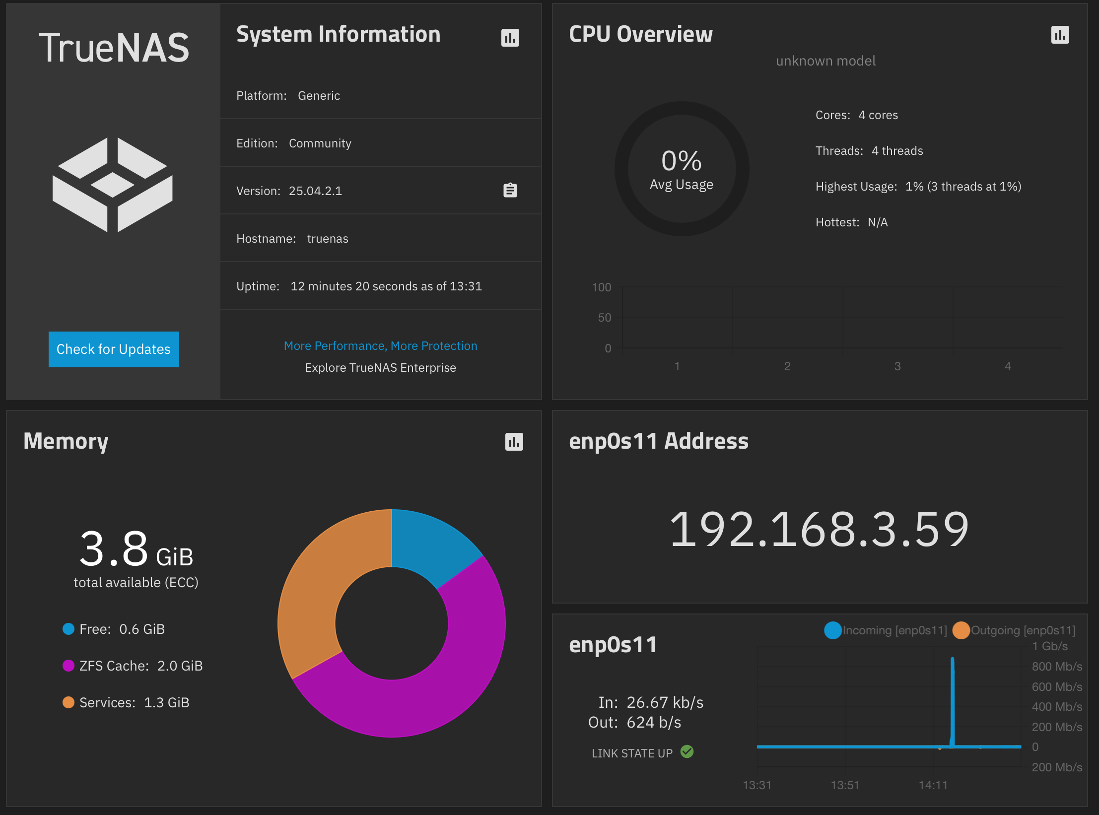

TrueNAS as VM on Proxmox on MikroTik CCR2116. Now to get this working on the RDS2216…

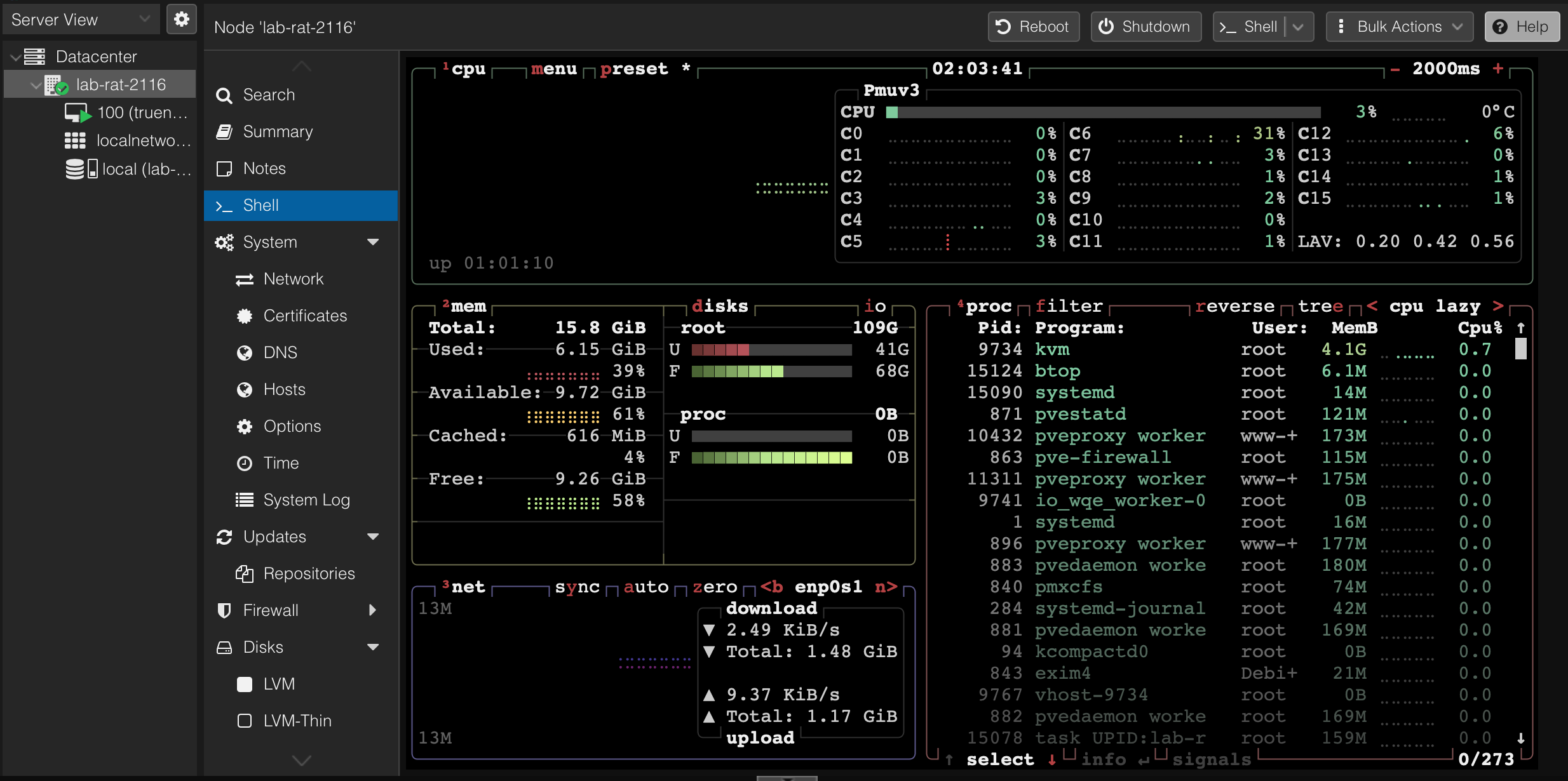

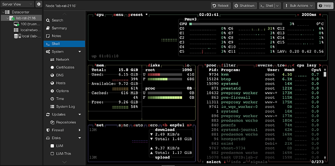

I have succeeded in getting the network ports on my lab MikroTik CCR2116 working with kernels 5.10 and 6.12.74, and it boots Debian (with Proxmox 8, PXVirt port).

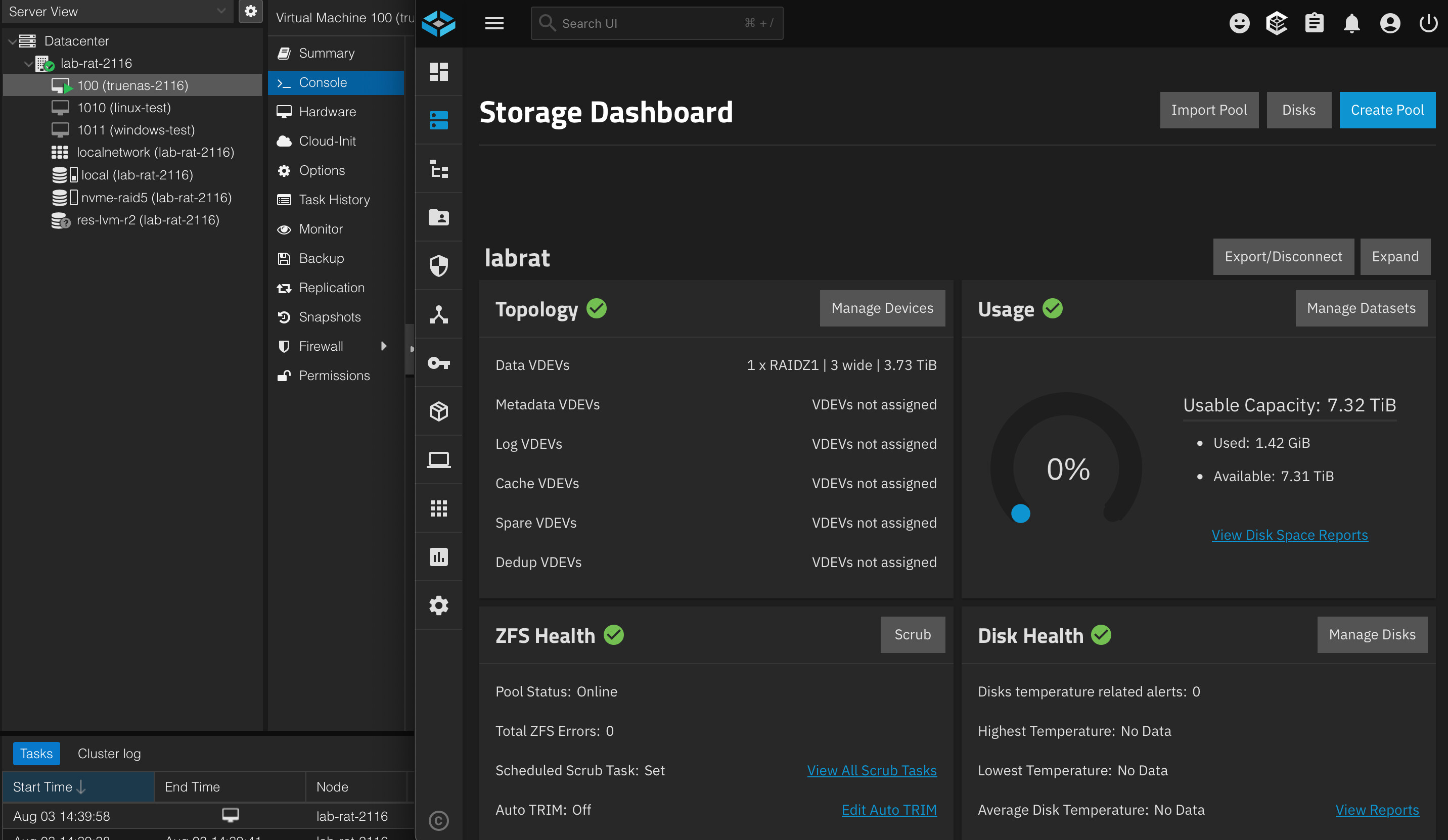

Inside of that, I have a TrueNAS VM with 8GB of RAM and three 4TB SATA SDD’s that I’ve passed through via “qm set.” (There isn’t a way to pass the HBA through, yet. The SMMU is disabled.)
I did some basic BlackMagic Design disk testing via SMB from my Mac Studio.
RAID0: 3x0 = 475MB/s write, 250MB/s read
RAID1: 1x3 = 400MB/s write, 200MB/s read
RAIDZ1: 3 = 400MB/s write, 200MB/s read
