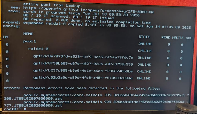

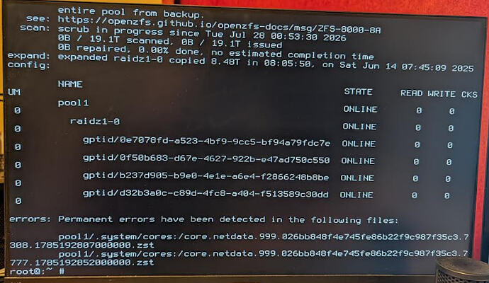

Great news! Here’s the zpool status -v pool1 output from FreeBSD. I’m attaching two screenshots showing the full results.
Key findings:
The pool is ONLINE with all 4 disks ONLINE and zero errors (READ: 0, WRITE: 0, CKS: 0). However, ZFS detected permanent errors in two files:
pool1/.system/cores/core.netdata.999.026bb848f4e745fe86c22f9c987f35c3.7308...
pool1/.system/cores/core.netdata.999.026bb848f4e745fe86c22f9c987f35c3.7777...
These appear to be netdata monitoring system cache/core dumps — not user data. This is potentially very good news if my actual data files are intact.

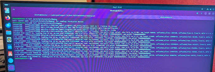

The source of the fault is probably going to be buried in the ZFS debug log during an import (a non-readonly one) so I would go back to the zpool import -f -R /mnt 7835538760692273829 pool1 command, and then depending on Linux vs FreeBSD:
Linux:
tail /proc/spl/kstat/zfs/dbgmsg
FreeBSD:
echo zfs_dbgmsg | mdb -k
Look at the last 20-30 lines once it stalls. Let’s see if it’s hanging up on the same spot or if it’s just furiously swapping metaslabs in and out.
Hi HoneyBadger,
I ran the debug log capture as you suggested. The zpool import is indeed stuck in a loop furiously swapping metaslabs in and out on vdev_id 0 — loading, then immediately unloading (346-347ms each time), then repeating with different metaslab IDs (903, 15, 848, 874, 878, 885, 887…). The old_weight and new_weight values keep changing.
This looks exactly like what you predicted — not hanging at one spot, but endlessly cycling through metaslab operations on the expanded vdev.
See attached screenshot of the debug output.

There’s a stack of unflushed_allocs and unflushed_frees in all of those metaslab juggles.
Are you by any chance using deduplication, or heavily leveraging block clone (lots of copy-in-place?) that might make it have to handle a lot of behind-the-scenes cleanup?
