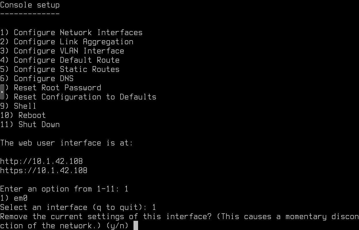

I upgraded from Freenas 11.3 U5 to TrueNas 13. It worked except it wouldn’t give me a web interface.
How do I do this?
Option 1 is configure Network Interfaces, it comes up with bgeo
What do I do then? Or is this not the menu option I need.
my static IP is 192.168.1.102 but I’ve nowhere to insert that via the console menu.
The console menu is all that I have.
Yes, I’m a simple mind but I do need help.
bge0 is probably the correct interface. You need to set your static IP address and netmask for that one by selecting “configure network interfaces” and then “bge0”. The system should guide you through the process.
Thanks.
I can’t seem to get past the bge0.
It doesn’t guide me through anything.
Sits on bge0 and laughs at me.
What magic button am I missing?
What exactly do you mean by this? Because you should be selecting bge0 by entering its number (presumably 1), and then pressing Enter, following which it will ask you further questions (as below).
“Select an interface (or q to quit)” - pretty explicit in my book. That’s where you press as Dan stated “1” and then ENTER.
Thank you. I finally worked out how the menu selections work thanks to you.
