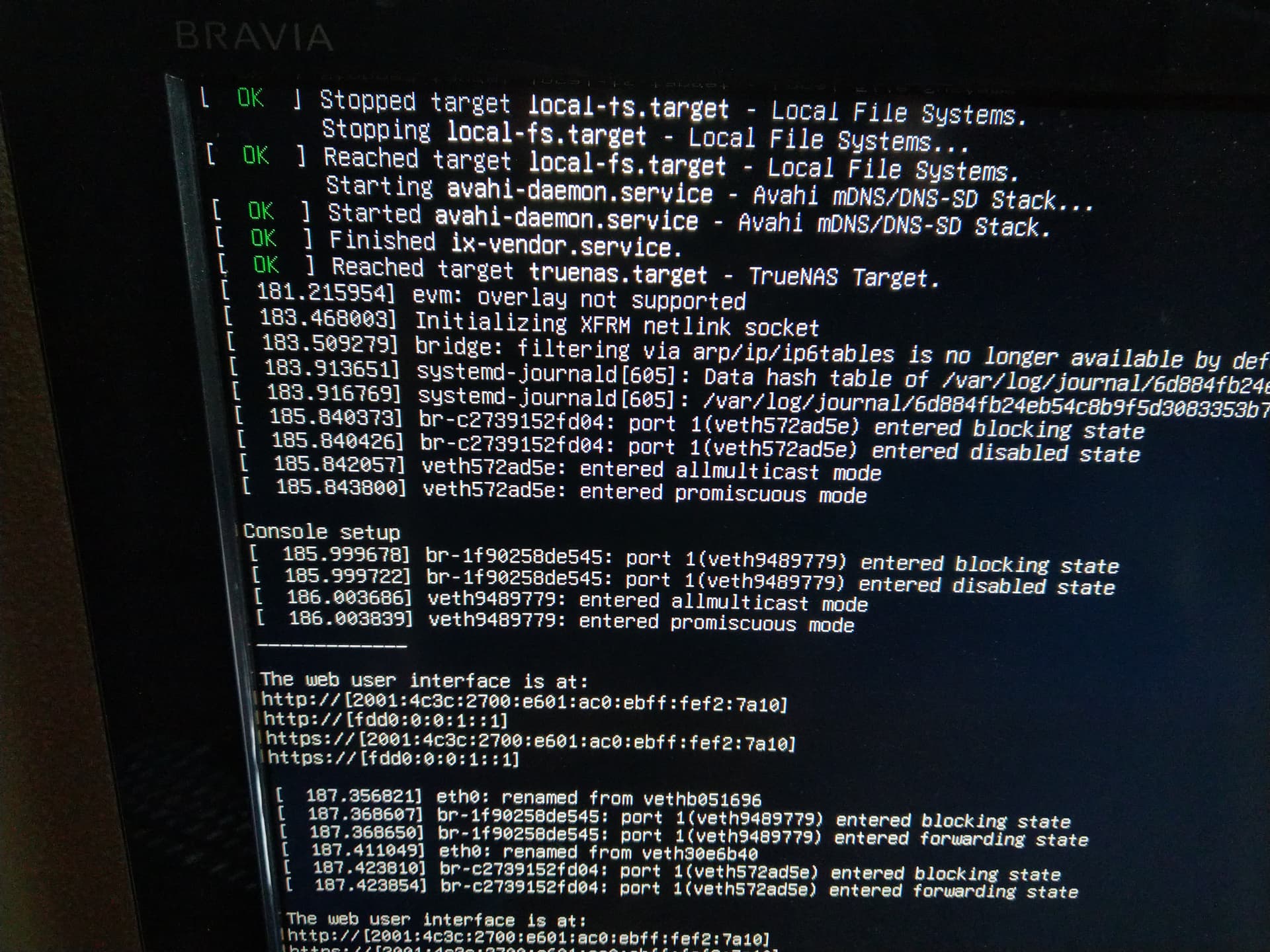

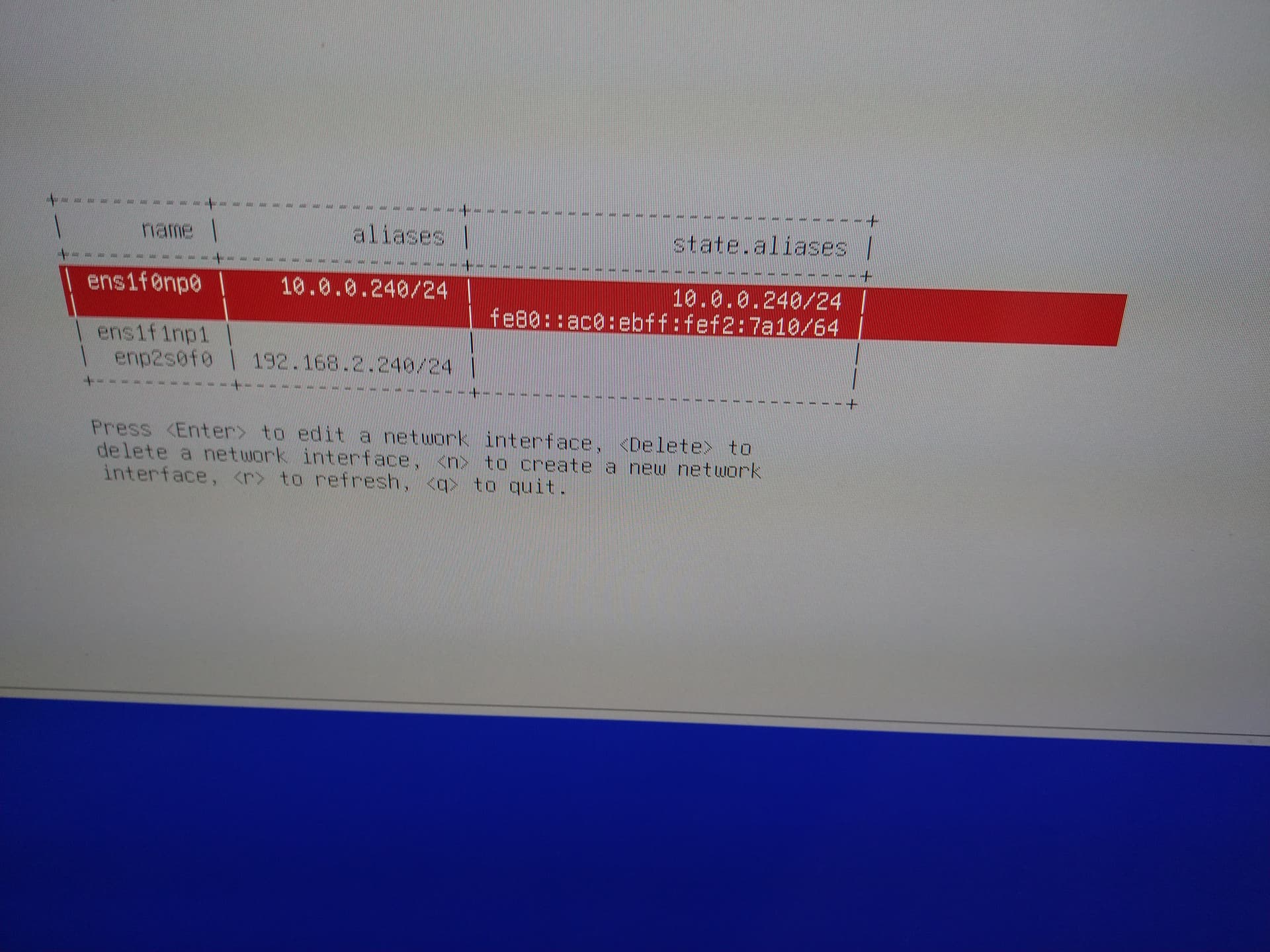

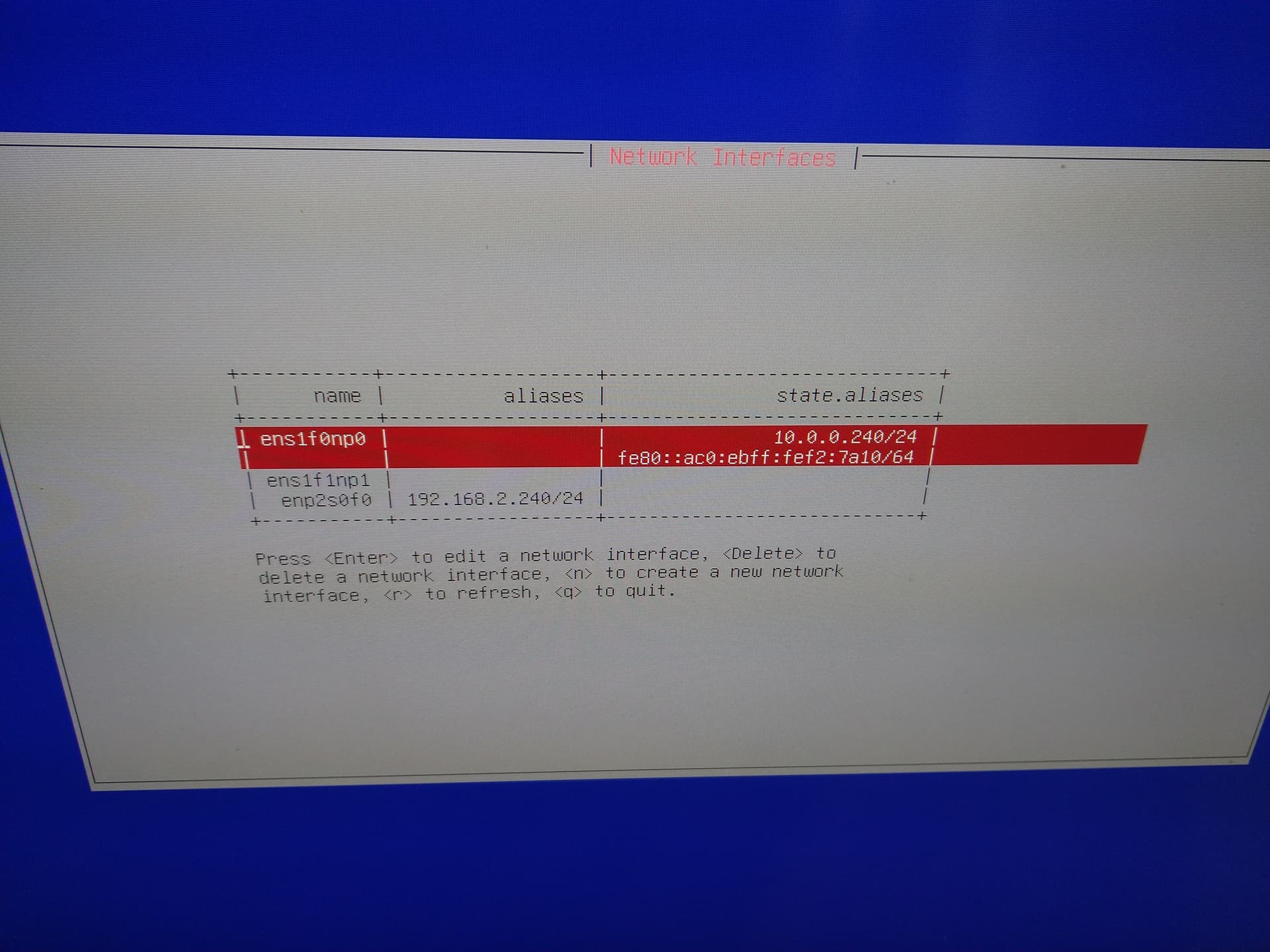

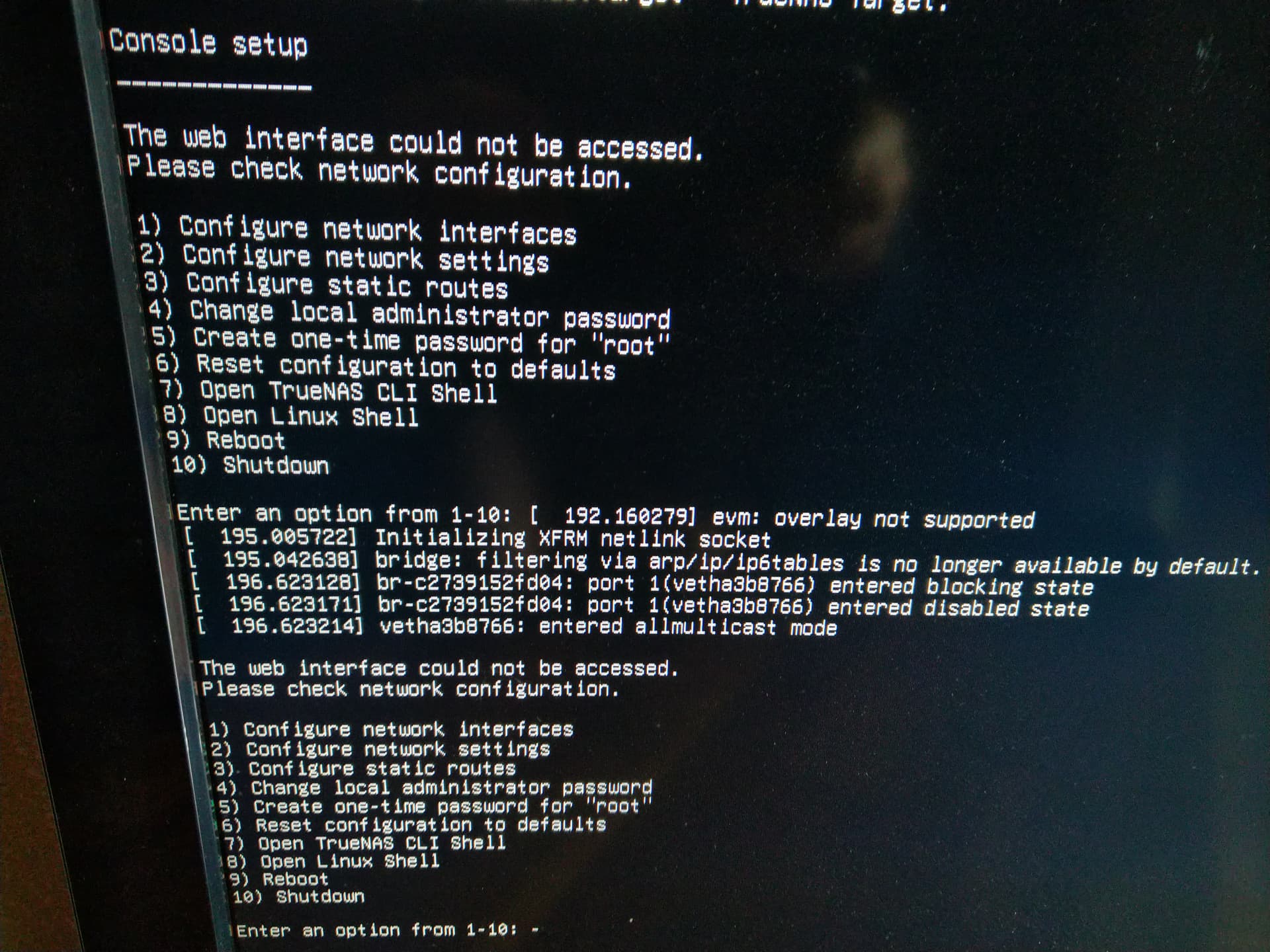

Pictures before setting webGUI IP ( Ipv4)
So it looks like you have no valid interface up.
- Which of those NICs do you have a cable attached to?
- Have you verified that the cable is connected correctly on both ends?
- There are two different networks visible on the second screenshot, which one is your client computer connected to?
- What is the output of
ip aandnetstat -tuln?
after setting webGUI to Fixed ip and webgui, instead of DHCP.
( so it could also be and DHCP problem, although i could ping to 240)
