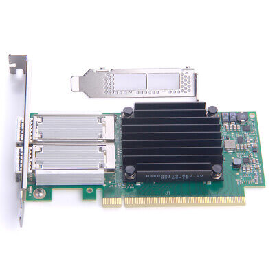

Then get a pair of Mellanox ConnectX-5 EDR+100GbE for 300USD

You can buy dual port ConnectX-4 for $140
