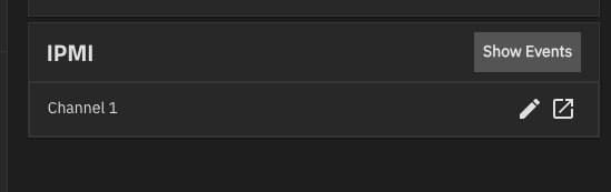

Are you sure about that BMC interface being really just BMC only?
The default for Supermicro is
  • dedicated IPMI interface if connected
  • failover to the first regular port if not - IPMI piggybacks the regular Ethernet
I’m just taking shots since I am not at your system. What you observe: power on Truenas → network meltdown, that just screams “loop” :slightly_smiling_face:
I am 95% sure it’s BMC only; it has it’s own IP & MAC address and doesn’t even appear as an option to chose in the Truenas GUI or CLI methods. As part of this diagnostic efforts, I’ve even switched all my BMC’s to a separate VLAN instead of maintaining them on the main network; I’ve heard that is a good idea for safety, as well, so it was time to make that change.
Truenas DOES show that interface as an IPMI channel, but doesn’t include it in any configuration options for other general networking.
