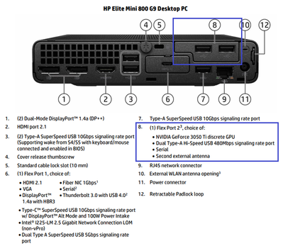

There is also a dgpu port that goes to 8x pcie. I tried to figure out if it’s possible to salvage this for storage but there is little to no information about this port online.
I don’t think that the mini has a discrete GPU slot.
Hard to believe, but my board has a port labeled as P80 INT DGPU & they sell a discrete gpu module.
